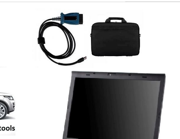

My nose has been hanging over this for a while:
https://www.ebay.co.uk/itm/294220572125
At that price I'm pretty sure that OBD2 adapter is a Chinese clone not an actual Drew product.
It is used, not new...
187 sold, he's using cloned adapters.
Fair enough. And another dream quietly dies...

Not necessarily - I have a clone adapter ($60 from china) - it works ok for reading the car. That said there have been comments that folks have bricked the car - not sure if they were trying to do programming. You could still buy the system and get one of these as Cee Jay posted a link to:
https://www.diagnostic-associates.co...thru-interface
