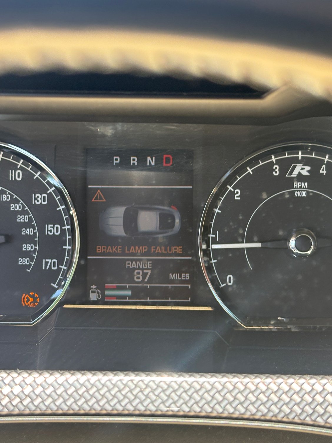

I checked all my lights and all of them seem to be working fine. Why does this keep coming up on my dash? I have tried disconnecting the battery and reconnecting. what could it be?

The bulb is on the way to failing but has not yet failed completely. Replace the bulb with a good quality new one.
It's a very common issue.
