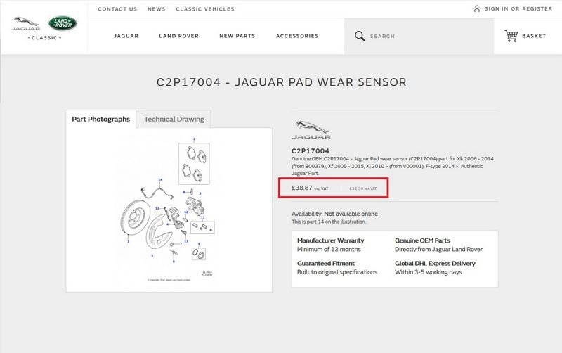

Front and rear sensors are different and so are NA and SC models so be sure to check P/N's One of the front sensors my XK (P/N C2P17004) crumbled at the last disc and pad change. The cost direct from JLR is an eye-watering 33.39 UKP plus tax:

Only a week before, a Jaguar Dealer in Scotland listing on ebay had sold me front discs and pads at less than half price with free carriage. Win some, lose some!
