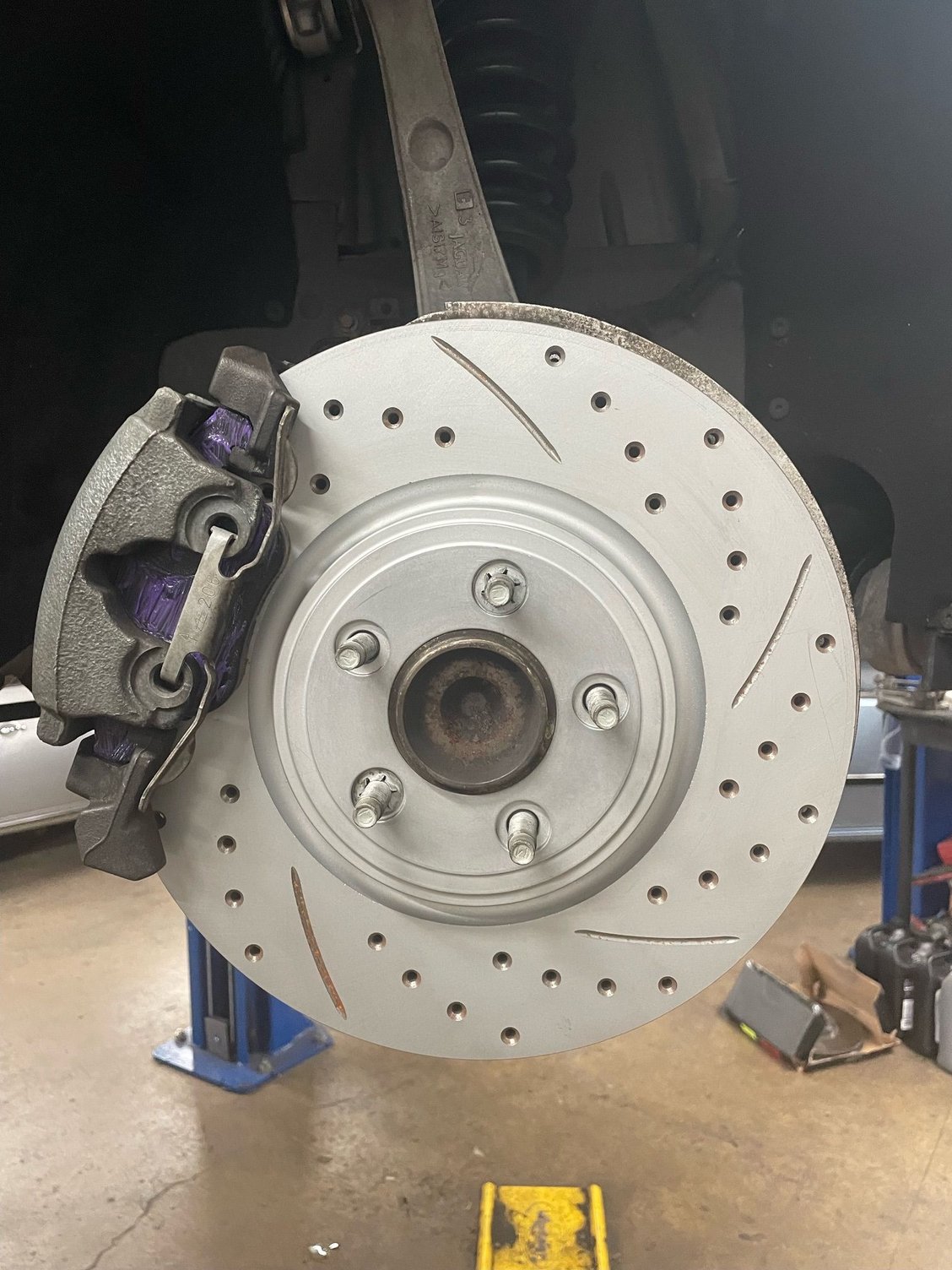

Old Mar 29, 2025 | 03:23 PM
wymjym's Avatar
Joined: Oct 2016
Posts: 1,779
Likes: 1,259
From: near Austin
Default Lemonade!
One good thing about replacing rotors all of the time, the fasteners come out easily!
I took my time and all told it took 2 hours to complete.
The brake pads still look very good, I block sanded them and reinstalled.
No more pulsing for a while!
Happy times...the sun is out and it's 80(f)...top down while seating the pads, woohoo.
wj
