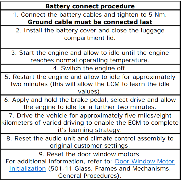

all normal. your car is prompting you to finish some of the re-learning procedures before you use it. i don't know offhand how much of the procedures for the post-facelift cars match your 2008 but here they are from my copy of one of the 5.0 manuals. you've just told it the extents of the windows, which i believe you're supposed to do after closing the top. as long as they jump up and down to meet the seal when you close/open the door, that should be good. you've suggested to it how thick your rear pads are, thus how hard to apply the e-brake. the ECM will relearn idle values and your driving style over time, but it can be trained before ever moving the car.
