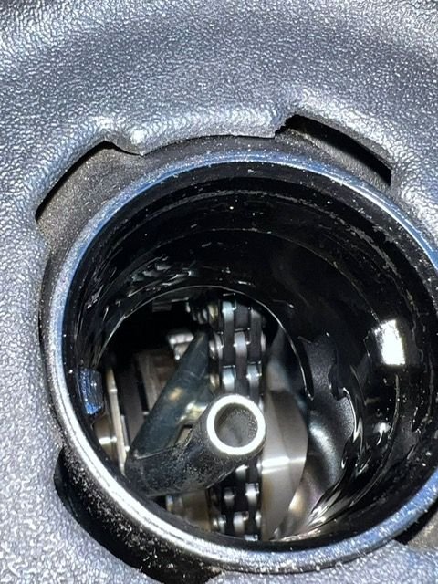

Hello, i am in the market for a xk 5.0 and found a nice one here in the netherlands. I am a bit afraid of all the horror stories about the timing chain. The model year is 2011. Is it correct that this one should have the tsubaki chain 6.35mm? When i look in the oil filler neck opening i can see it has the 8.0mm ina chain inside. Is it a correct assumption that the car has an upgraded set of guides and chains? The mileage is 82000 miles. The car is a usa model with a carfax report with it.

The 8.0mm chains are the later ones.

I would believe based on the data that your chains have been replaced.

Thanks for the replys. I thought it was replaced but was in doubt because of all the different posts about this subject.

The 6.3mmm subaki chains and tensioners are more expensive and superior fyi,
The reason one would convert to the 8mm chains is because the parts are alot cheaper
and easier to find than the subaki parts.
The later chains was for cost savings. There's in depth explanations with pictures in the XF section of our forum.
