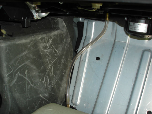

First of all I want to thank Hawaii for this ingenious idea. I take NO credit! This will save you lots of money and is a great inexpensive solution to the problem. I did the repair in about an hour and thought a few pictures would make it easier for some folks. Again thanks to Hawaii!!

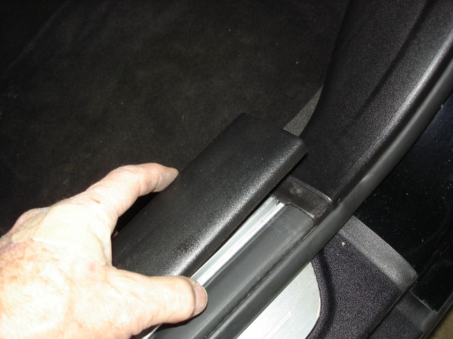

Start by pulling the door sill panel up with your hand. Then the side panel in the passenger footwell pulls back toward the rear of the car to remove.
then pull the carpet back to get access to things. It takes some effort as the carpet is stiff.

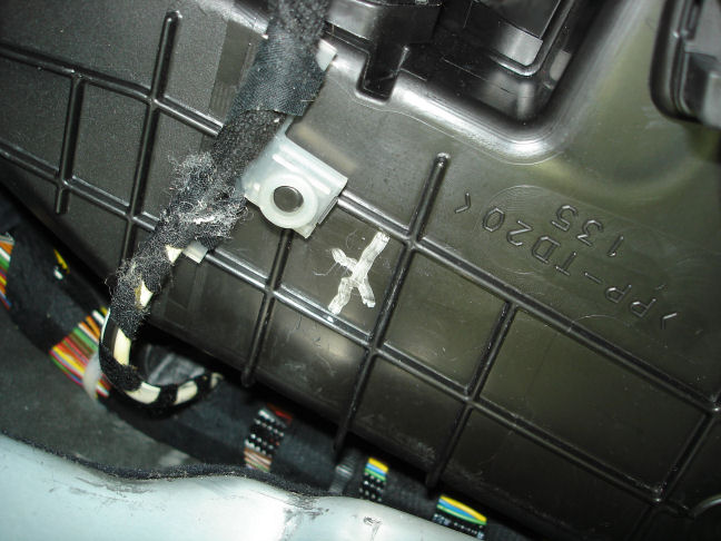

this is the view looking up at the plastic box which contains the condenser unit inside. It is slightly lower at the front of the unit, but its hard to drill a perpendicular hole in this area, so I targeted one with an X a little to the rear
A right angle drill gives you more room to drill. You can see if I chose a site closer to the front, my drill would have to be angled preventing a perpendicular drilling approach. I drilled carefully as Hawaii recommended but after I broke through in this location there was nothing inside to damage.

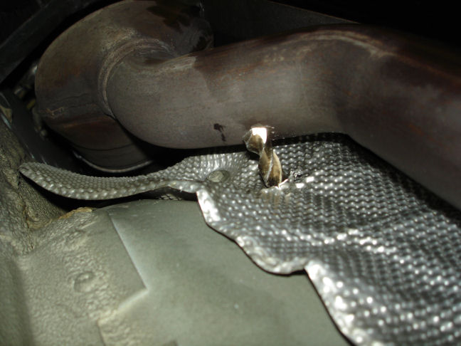

This is the site I chose to drill through the floor. It worked out fine but you may want to go a little closer to the outside of the car (away from the transmission tunnel) The picture below shows where I exited beneath the car.

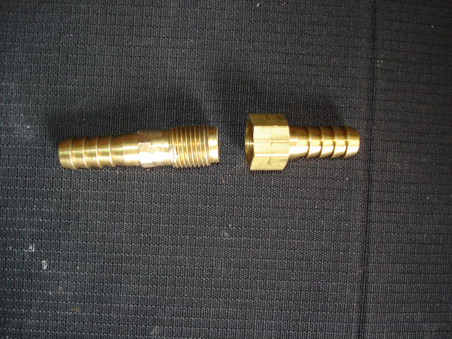

Because of the proximity to the exhaust pipe I decided to use a brass fitting. I was concerned the plastic tubing would melt and seal itself. I found some brass fittings in my "junk" drawer that worked out.
I assembled these parts and put the long end through the flow secured by some JB Weld
I put some JB Weld on the threads of another fitting I had and threaded it into the condenser box.
from there I just routed a plastic tube between the two brass fittings.
I tucked the carpet back in place and replaced the panels. Looks good!
My thanks again to Hawaii for this tip. PM me if you have any questions!

i hate to tell you to pull your carpet back up, but i think a hose clamp is called for on that barb down at the floor, at a minimum. good on you for realizing the exhaust is a concern, but the heat will of course also heat that fitting up and conduct it upward to the hose. really, you may as well use hose clamps on both ends purely to account for vibration over time.
This attempted fix seemed logical to do & I tried it myself. Unfortunately it did not work for me or the Dentist who posted these pictures. He and I later discussed what we learned from this wasted effort. What works consistently for the XK plugged duckbill is the two home made cutting tools on this thread that cut open or off the duckbill. Before drilling into your Jaguar, do all you can to find the shop manual for your X type and look into how your A/C drains the condensation & where. The pictures shown above are an attempt to drain the overflowing condensate water before it reaches the “Blower Fan” & shorting it out. It was placed on the same plane as the fan, not the lowest point (where the stuck closed duckbill is located). This failed because the large volume of accumulated water condensate sloshed beyond that small drain and still
