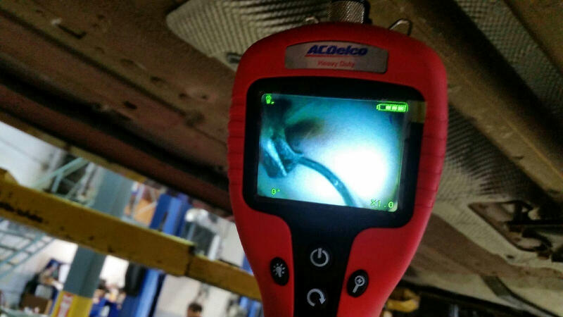

I tried all the tricks in my 2007. Closed vents in recirc, tried to pressurize system using high volume air all to no avail. Took it to my mechanic. He removed rear transmount and went in with a scope. Once found, he used the scope to guide a air gun with 2ft extension. Opened up duck bill and a tremendous amount of water came out. then inserted the air gun extension into duck bill and blew air. Once fully opened, he put silicon grease between the duck bill. Photo shows air hose extension in duckbill
pphoto. .
Attached Thumbnails A/C water in Passenger foot well-2007-scope.jpg

Hey jgivoo,
Soooo the BIG question is has it worked?? Was that done in 2007? If so you have 7 years to report back on. If the fix has been successful I'm doing it! Thanks!

In a follow up today, my mechanic stated that dropping the rear trans mount did not gain much as far as access. He stated the scope and air gun fix is the way to go. He additionally put a piece of small rubber tubing between the duckbill opening to insure it never fully closes again. I will report back in a few months or hopefully years. The fix has only been a week. Good luck. Hopefully I will get another 7 years out of it.

Wow your mechanic has great hand skills! I'm glad you mentioned the tranny drop didn't create that much additional room. I was about to try it. I can't imagine how he was able to get an extended air gun into that space while viewing with the scope! I had mine on my lift and its VERY limited in space!
