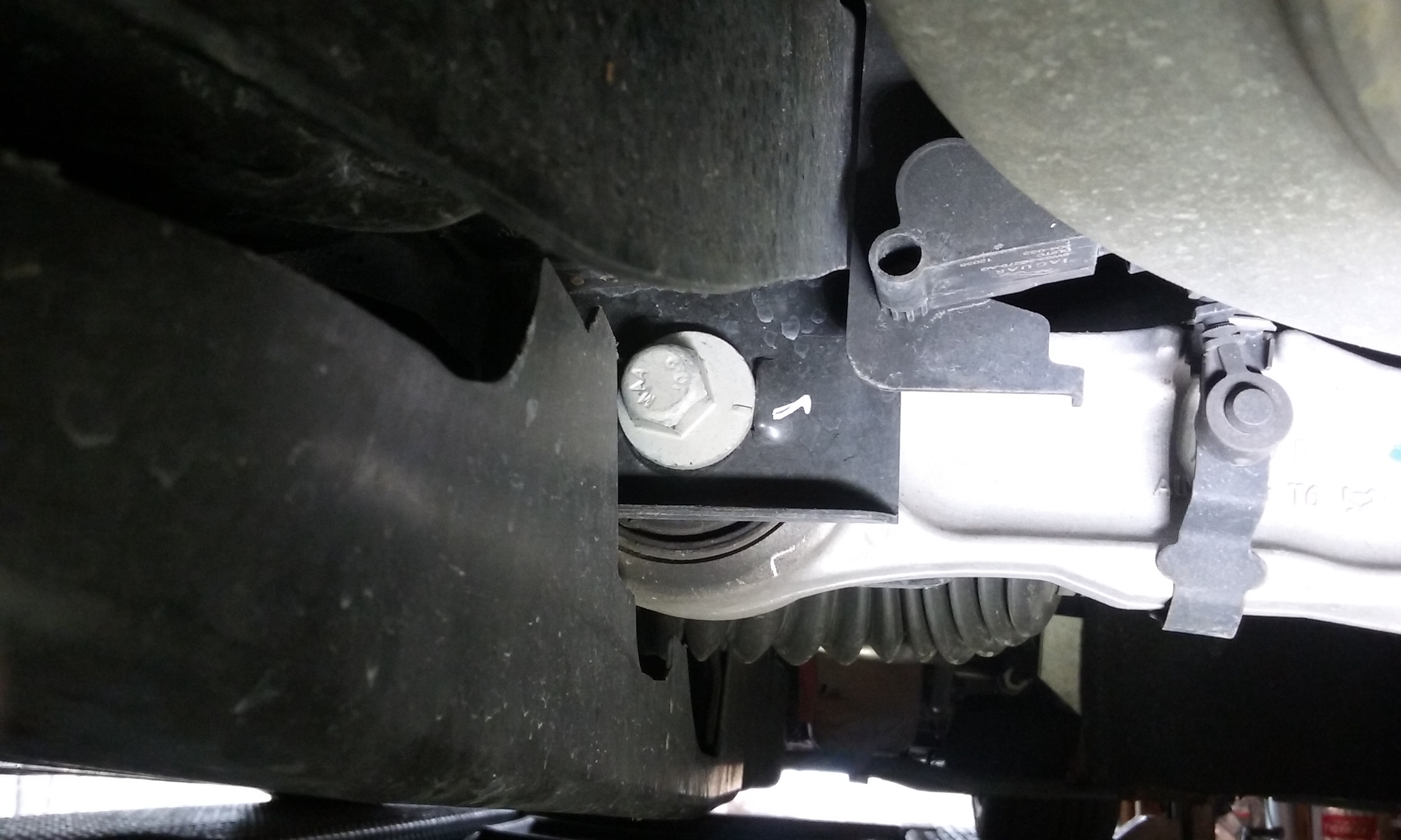

OK got the car back today and drove it 80miles back home on all thruway driving. Also had the 2 new front Conti DWS installed on the front. They started from 0 and did a total realignment and at no charge to me. The results were extremely good and they look like they hit the factory marks. Care run super at 70-80 mph and the tires so far are excellent for being smooth and quiet. The car track very good. here are the numbers and the pictures to show the alignment marks.
LF camber -0.5* LF caster 6.7* LF toe 0.12
RF camber -0.8* RF caster 6.3* RF toe 0.12*
Total toe 0.23* Steer Ahead 0.00*
Attached Thumbnails Camber adjustment question-new-left-camber.jpg   Camber adjustment question-new-right-camber.jpg

I see that they took the right front eccentric all the 180* from
the pre-alignment position ... like I thought they would.
The left was just a small tweak.
When I talked to the service manager and the alignment tech before the re-alignment we discussed the factory paint marks and to start back there to see if the front end had any wear that would prevent it from putting it back to factory. They also did some caster work and that made a little difference. We'll see how it works out.
