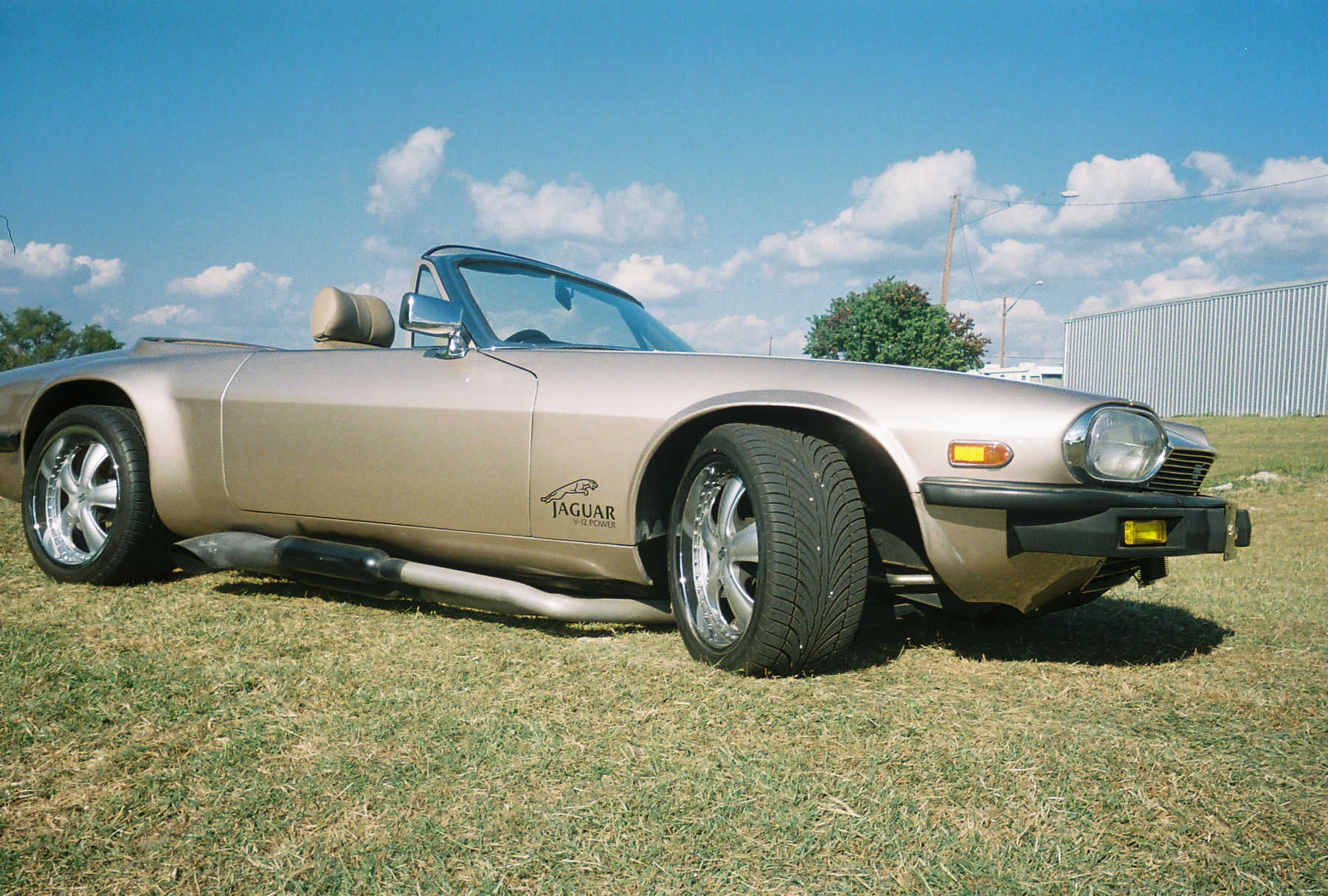

i deleted all factory piping, no matter how you arrainge the rear or side exit exhaust Jag V12 system you will hear 1st one side then the other, its mixes up the smooth cadence of the 12 cyl.exhaust note!
so me working, out of a different tool box(mind set), i came up with ALL 12 cylinders out of ONE 5" dia. outlet.
i have had many compliments about the sound, even from V8 guys!
believe me there is NO backpressure, custom made the 2 manifold outlets into a large 2 1/2" down pipes per side, then thru 2 straight thru mfflers(2.5" in and out).
they blend at there outlets, into a 5" flared turn down exit pipe!
you cannot believe the sound all thru the RPM ranges, but it really comes to life between 3500/4500rpm ,just when torque peak starts coming on!
it sounds like a scream at 6500/7000rpm.
YES its a little loud, but coming to you and passing away its fantastic!
also a sound clip does no justice for it!
also helps to be a true motorhead guy!
