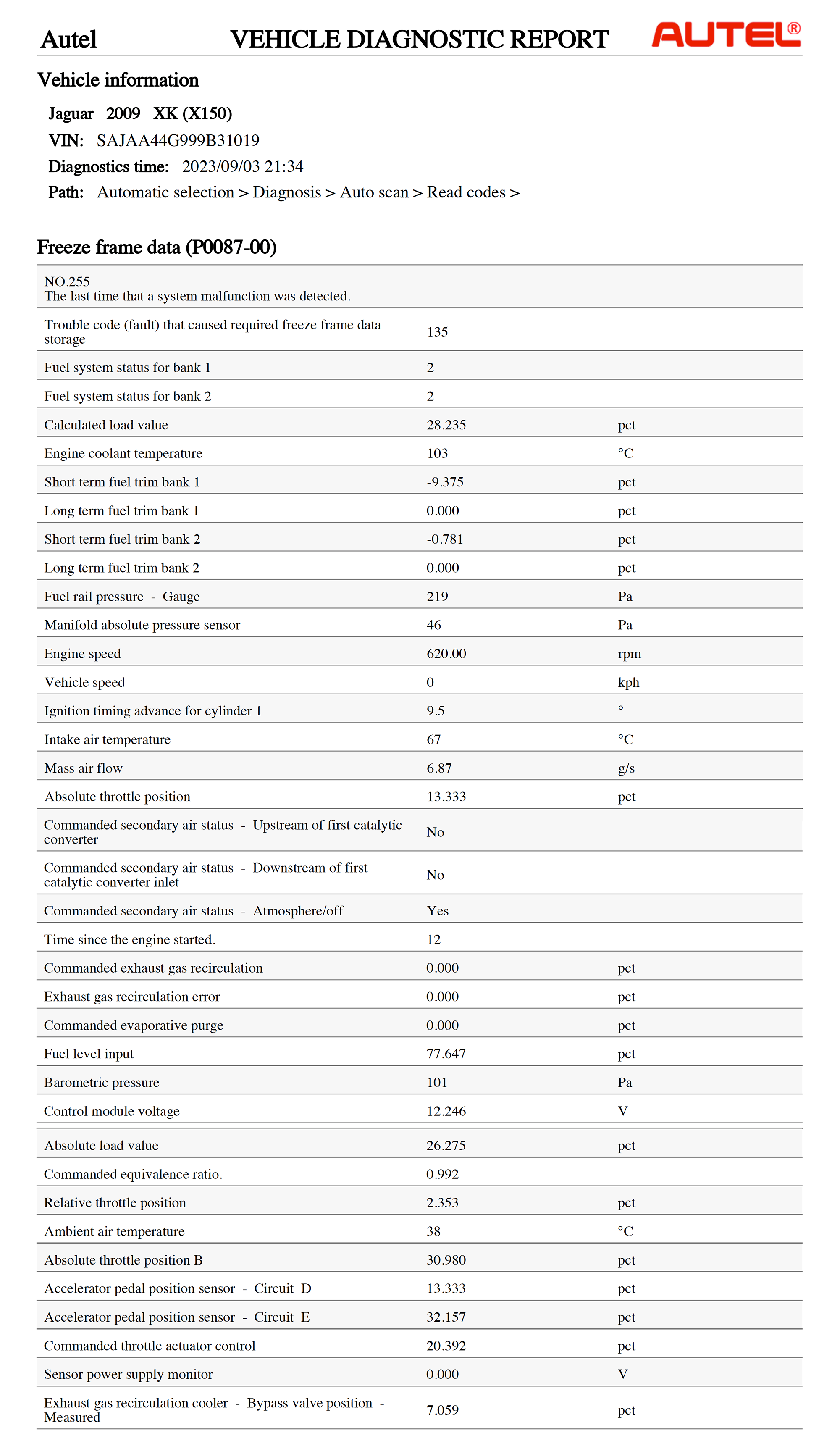

I have Code P0087 - Low fuel rail pressure Bank 1.
The symptoms are the car will drive normally for a few minutes, then suddenly splutter and then engine will die.
It is then difficult to restart the engine, but once started it will run again for a few minutes until it splutters and dies again.
I changed the fuel filter and the fuel rail pressure sensor already.
I just bought an Autel code reader and did the freeze frame a few days ago.
Not sure how to interpret the data - I can see "Short term fuel trim bank 1 -9.375" - is much lower than bank 2.
Date is pasted below - PDF of data attached.
Can anyone help?
Car is a 2009 XKR 4.2L.
Many thanks
Steve

What I'm confused about is code "P0087 - Low fuel rail pressure Bank 1".... yet "Short term fuel trim bank 1 = -9%"
So ECU thinks the mix is too rich (too much fuel) - but the P0087 code is not enough fuel?

Hi @MuscatCat Yes he means fuel rail pressure. Your reading is showing pa (Pascal) of 219 which equates to .031 PSI. I presume that's what the pa is representing in your Autel output. Normal fuel rail pressure is 65 psi.
I'll change the settings next time.
Guess I need to check the electrical connection to the pump somehow.
I have the back seats out and can see the connector, just need to work out how I can test it..
I can't hear the pump turn on (not sure what I should be hearing).. but the car runs for a few of minutes after starting.. so it seems its not completely dead (if it is failing)..
