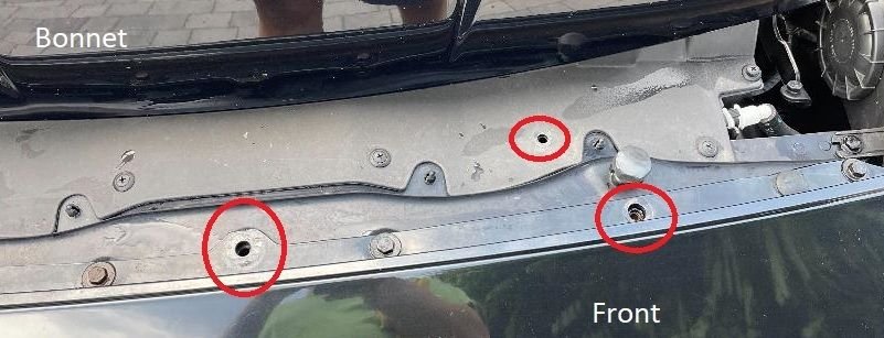

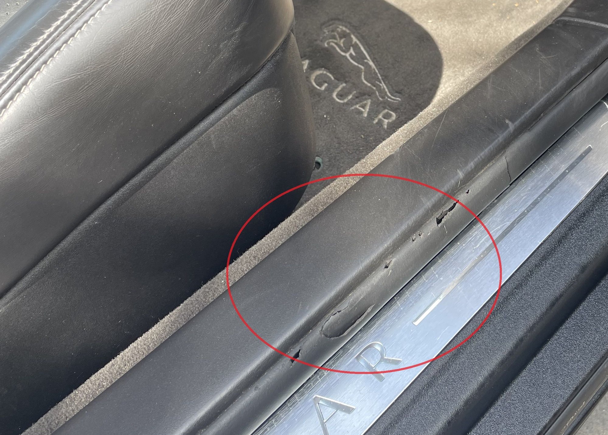

Hi all,
I'm starting to go round my new 2008 xkr purchase and identify bits that need replacing. I've found loads thanks to this forum but I'm struggling to find some missing screws in the engine bay and a seal on the driver side. Photos below. i have searched for engine bay screws and door seal but cant find the exact bits I need. Any help identifying the part numbers, or what they are actually called or even better a place to buy them from would be much appreciated.
Old Jul 26, 2022 | 08:46 AM
That looks like your're missing two M6 x 20mm bolts from the front wing and one of the plastic scrivets from the trim panel. Nothing special about the bolt and the fixings are available from aftermarket parts specialists.
The Part Number for the door seal depends on Coupe or Convertible and VIN range.
Regardless, you won't be going anywhere but Jaguar for that.

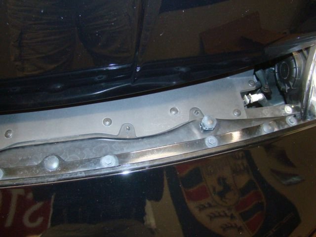

Push-rivet in the center, Bolt to the driver's side, and scrivet to the rear. You can match all of them with existing fasteners
