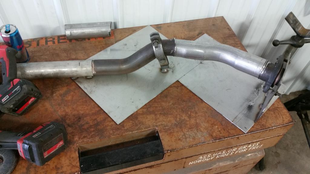

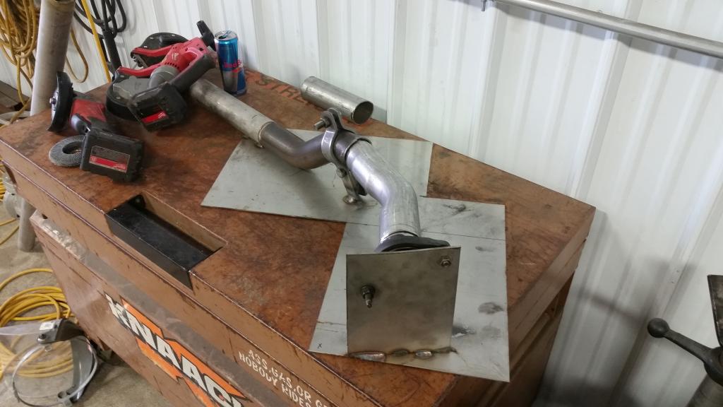

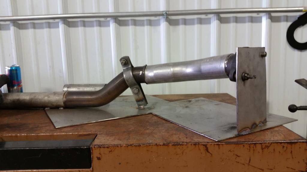

So, Ive been searching both local and online for someone who can make me some cat-delete pipes, and I havent had any luck. The best answer Ive gotten so far was from a place semi-local and one place a "maybe", but Im not going to ship my parts across the country for a "maybe". So, I decided to tackle this myself. Now, bear in mind that the part I used to replace the cat is NOT mandrel bent, and is NOT stainless steel. This is simply a mock up, and the semi-local place that does this stuff all the time simply told me they couldnt scan the part to make a new one because the housing was too big. So this is just a "temp" part, if I like the way it sounds and performs I will send the parts off after Im done fabricating I will send them to that place and they will scan my custom made part and re-fabricate the entire thing but in mandrel bent SS. Also, the rest of the system is stock for now except for the rear muffler was deleted before I bought the car. My only concerns are that it will be too loud without the cats, so I intend on going with an aftermarket "cat"-back exhaust with a rear muffler to combat the noise (if it is too loud). Anyway, on to the pics, and, it is only tacked up for now until I have both sides fabricated and test fit, then they will be welded, painted with high temp paint, and installed for a while to test it out.
Also, I am no exhaust guy, I am an industrial Pipe Fitter so this inst exactly my forte, but I do know the proper way to cut/fit/weld any kind of pipe/tubing. I am TIG welding all seams, any excess penetration will be sanded smooth for maximum flow since its not a mandrel bent part. I am using 309 tig wire in case any one is wondering, Im not sure what the stock exhaust is made out of but it is very attracted to my magnet, so one would believe its just carbon steel but Im using the 309 to cover any possibility of a hybrid metal. For what it is Im sure it will work just fine, and its temporary anyhow.
Attached Thumbnails And the cat-delete begins!-20140610_081343_zpszhvfvtj0.jpg   And the cat-delete begins!-20140610_143009_zpsiucxwi3n.jpg   And the cat-delete begins!-20140610_143020_zpsqegjb3as.jpg   And the cat-delete begins!-20140610_143029_zpsmuiqmlpi.jpg

btw, I guess in those pics I didnt have it tacked yet, thats why it looks off a bit. I'll get some better pics tomorrow of the other side and of both installed for the initial test fit on the car after work.
