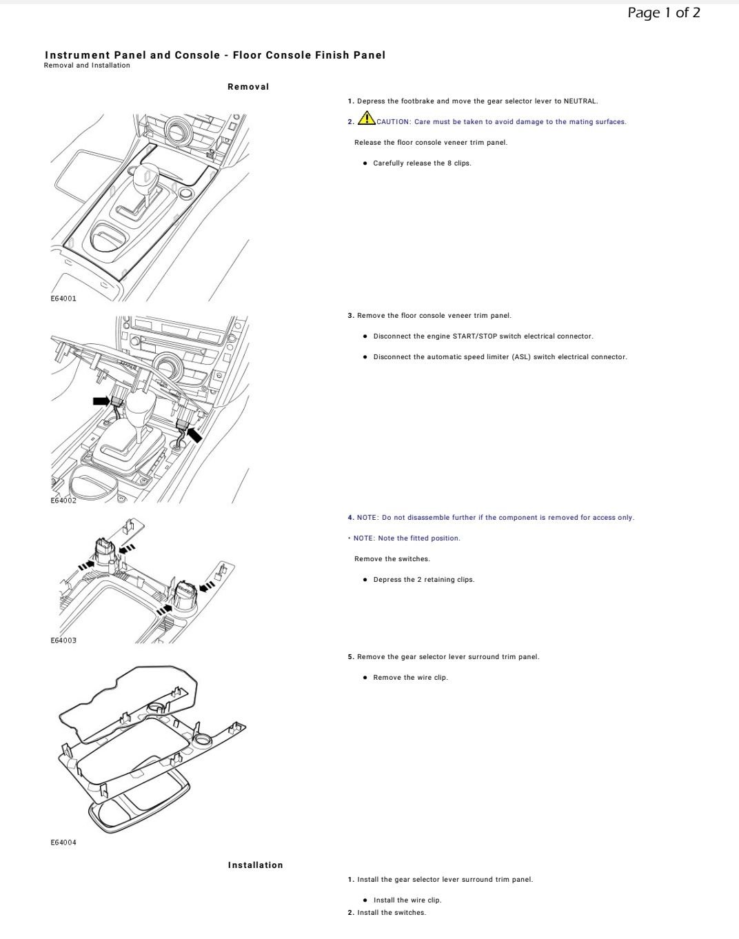

Open the link to this .pdf, (Attached Files, below), and scroll down for detailed removal instructions.
If this was helpful, press the button on the bottom right.
File Type: pdf
