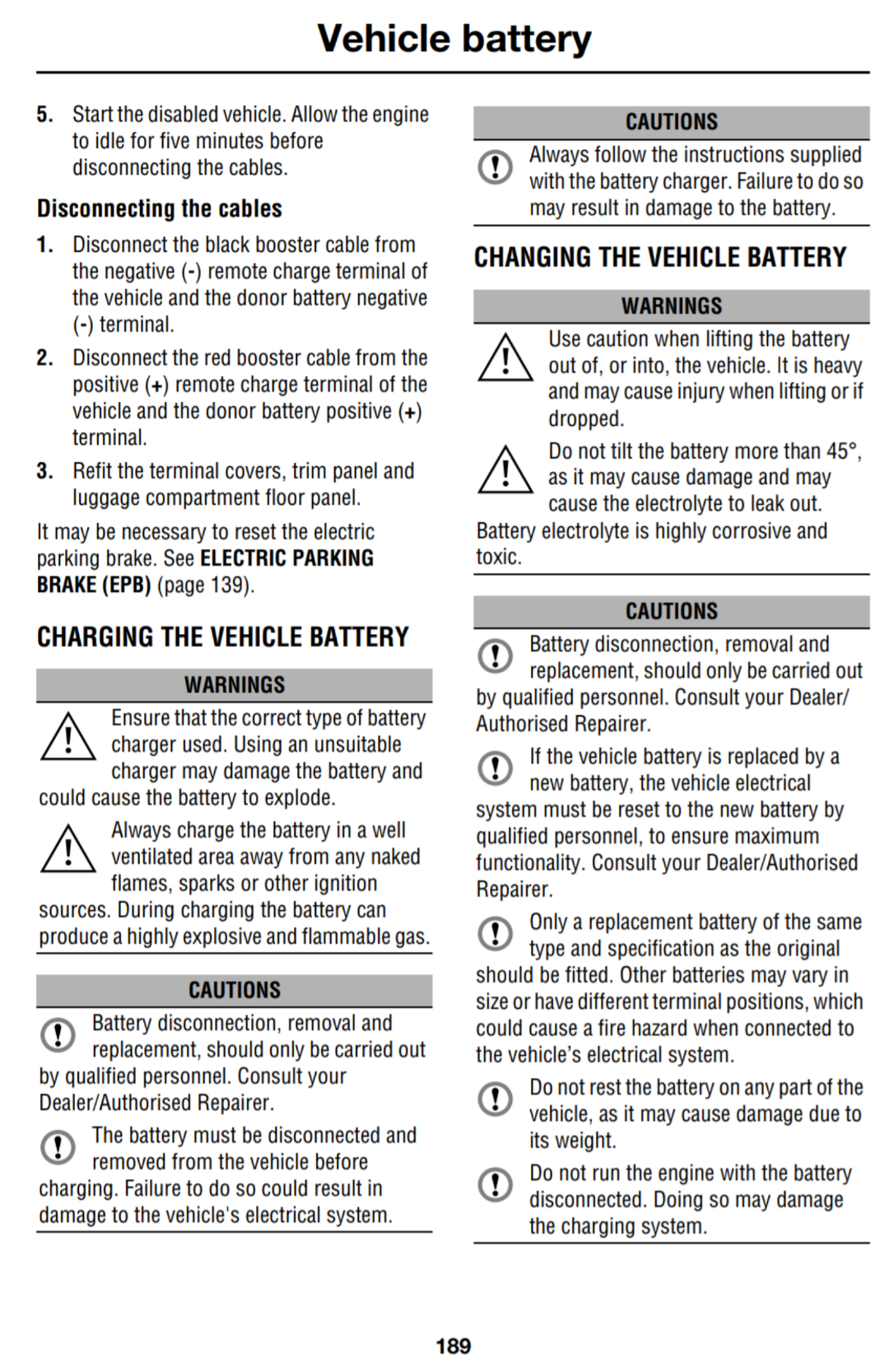

I don't know about UK market X150 models but, to the best of my knowledge, North American market models never came from the factory with an AGM battery. Sure, many Forum members have made the switch from flooded (wet cell) to AGM, but the alternator's charging profile is for standard wet cell, not AGM, and an AGM battery might never get fully charged ... unless you use a CTEK or similar battery maintainer that includes an AGM setting.
