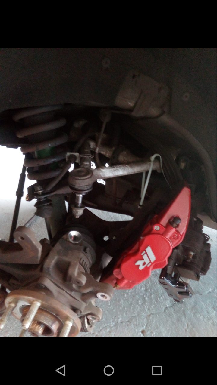

So I’ve have searched the forums and really haven’t found anything as to how to remove the Eparking brake assembly from the rotor. I am familiar with the caliber removal but is there something I need to know specifically on how to remove E-parking brake assembly.

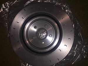

My rotors are heavily scored so I have a replacement set of Eurospare identical rotors. I am also installing Kevlar/carbon pads all the way around from Porterfield R4-S their Street version of racing pads.
I just need to know about any quirks / tricks there may be with that parking brake removal / reinstall procedure.
Thanks in advance!

I do understand the use of machining the old rotors as I have always done this in the past as well as working in a brake shop in my earlier years. However, there is over .025 of lip top and bottom both sides. So new rotors are in order.
I need to know about removing the e-brake parking caliber on these cars and the quirks or newonceses associated with removing and reinstalling the parking brake caliber

I've changed the Alcon rotors on two separate vehicle
