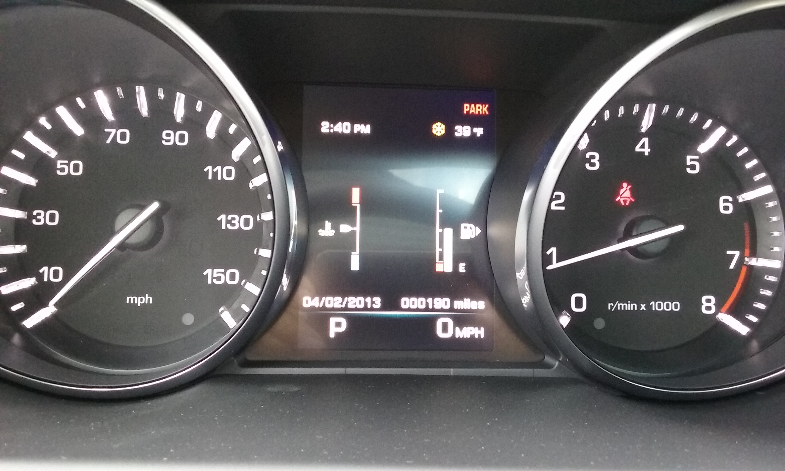

While my car is getting the alternator replaced I have a 2016 Land Rover Discovery as a loaner. Something I wouldn't buy but an OK little loaner car. What is interesting is here is a snap shot of the instrument cluster. Water temperature gauge anyone. This is what should have been on the XK.

I'm still in shock, for the finesse and performance these cars have, there are no gauges.
I too use the Helmand and have an iPhone. Love my iPhone. I have a Galaxy S4, I can use with an alternative ODB reader.
