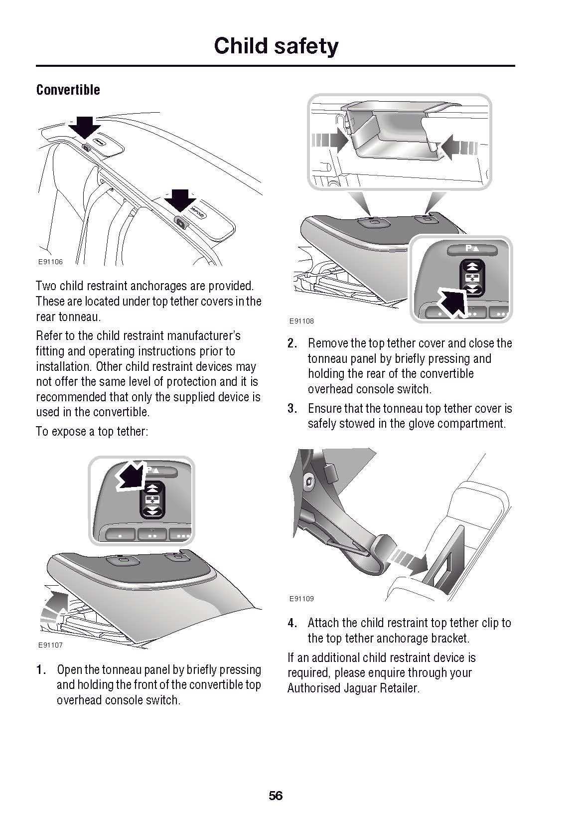

Have a look behind the rear seat back, easy to remove, and see if fitted or at least mounting point for anchorage

My convertible has hook anchors. I thought they were mandated at some point.

Its from the 2010 manual JJM 10 02 30 101 which I think is the UK manual. Anyway you should have a look at the "parcel shelf" on your car and see what's there.
