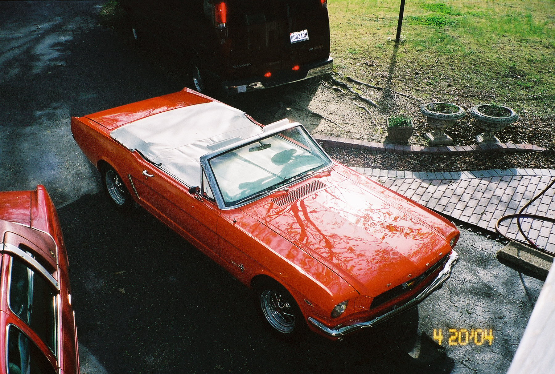

I like the simplicity of my mustang's top. Once it's raised, I "hook 'n go" and "manually" role up my windows. No fussing and waiting for them to raise or get stuck, no fiddling with a cover thing-ga-ma-jig in the trunk. And certainly, no "JagWrangler" "auto-ma-bob" push button key fob gizmo, that took a couple hours to wire. (LOL) ...and yes it does have a tonneau too.

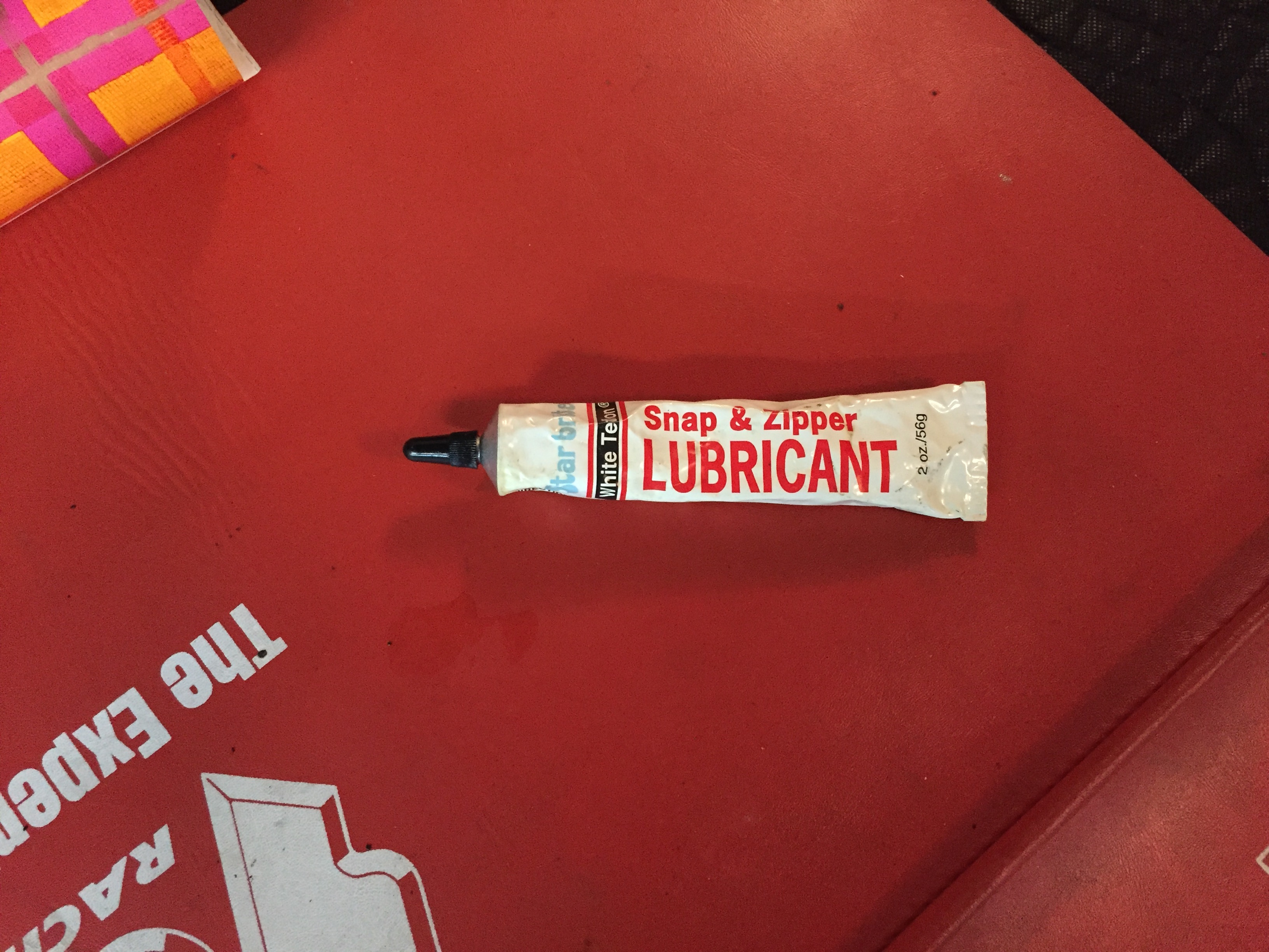

My most vigorous and oh so simple maintenance, is the occasional use of this....

Sometimes the old way of doing things proves to be the best. My 66' Mustang was the same way, power up, hook n go.
