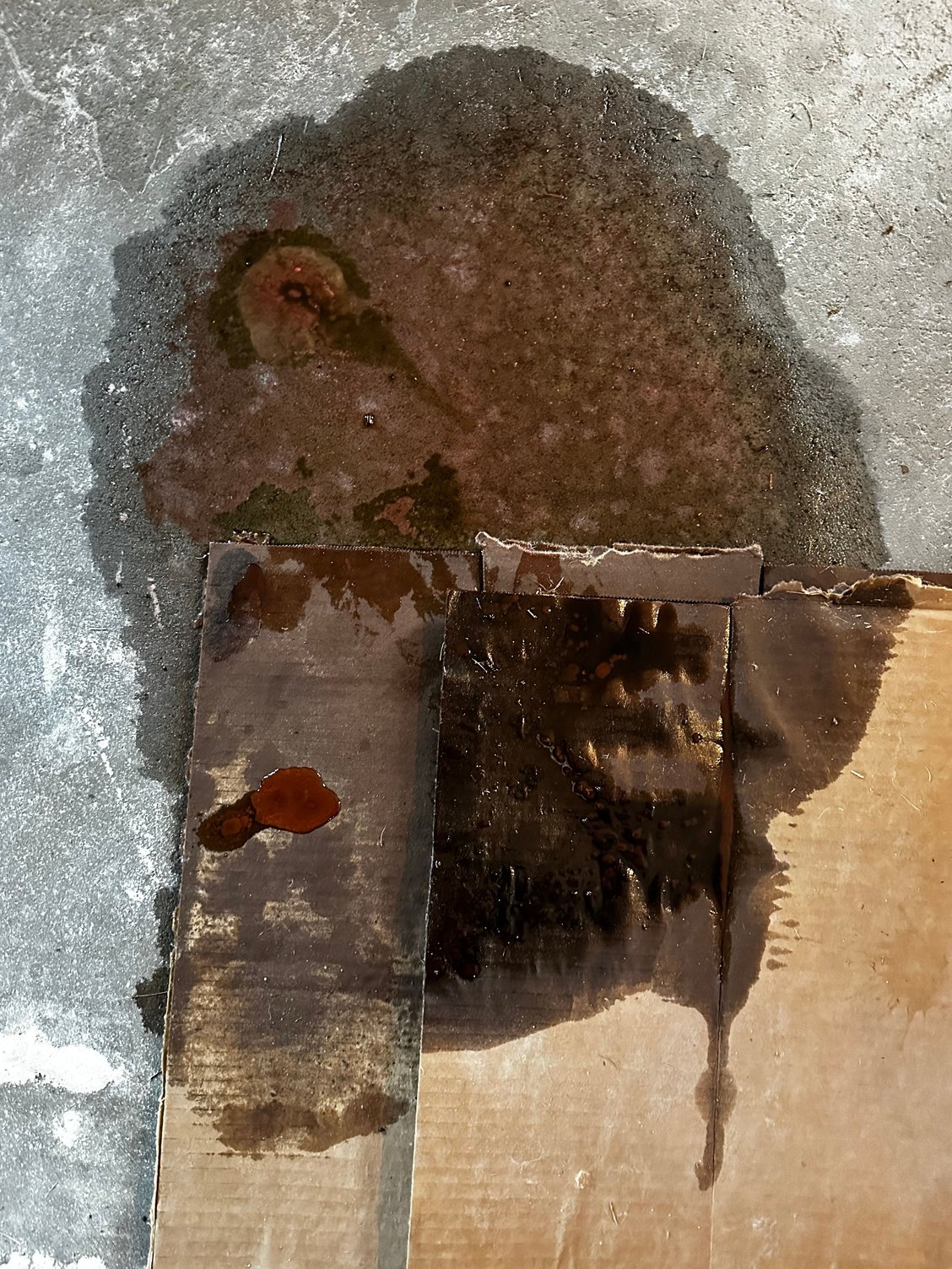

Dear Forum,
I had NGK Plugs & Coils installed on Thursday as there is 105,000 miles and from looking at the Service history I didn't see Any tune up info. Well Thursday when I brought it home it seemed fine runs great, drove it to the store a mile each way yesterday around 7:00p central and then today I went to take it out started it up and got a red triangle Coolant Low.. This is what I found when I pulled it out.. I always leave Cardboard under the engine just in case measures...
As you can see I checked the leak under the driver side after backing up.. The Leak has gotten larger so now I'm thinking it could be serious.. I had no coolant issues prior to the Plug & Coil replacement... I'm contacting the garage in the morning, it happens to be a FORad service center. They know my car.

Look at coolant tank for cracket outlet.

There are so many places where coolant could be leaking from that speculation is likely to be incorrect. Looking to see how far under the car the leak appears to be dropping from and the checking the whole engine bay / bellhousing from above and below is the best way to proceed.

I agree with RichardS. Coolant leaks are so common it’s best to check the whole system as it could be anywhere. No reason to throw parts at your car.

Well it looks as if it’s not the reservoir tank as it’s empty and I’m still getting leakage. I ordered antifreeze which I’ll mix 50/50 as It’s PEAK for Jaguars same as I used before.. I need to drive the car 12 miles to service it.. I’m hoping I can top it off and wondering how much has actually leaked?.. I believe that is the only way to put coolant into the system is through the reservoir?..
I think it will be ok to drive 12 miles?

It looks as if it has been replaced, new outlet tubing with worm clamp. The tank is empty and there is still coolant leaking?... I'm thinking water pump, radiator seal, or one of the many plastic parts.... Why aluminum wasn't used as it's as light as plastic. I have a '95 Cannondale Killer V 900 Mountain Racer completely reconditioned to showroom spec, you can hold the frame with your pinky.. Aluminum Alloy 6061 Super Strong and feather light.

Matusco you may want to remove the engine cover and examine the small hose from the tank running along the intake manifold valley, towards the front of the engine. Midway along there is a straight connector that deteriorates and leaks on the non R 4.2L model. But the same procedure can be used on your model. Follow the hoses from the tank.

Remember there is that insulated tray underneath the car! With that much dripping, it's probably saturated and the drip location can NOT (necessarily) be located by where it drops onto the floor or ground.
