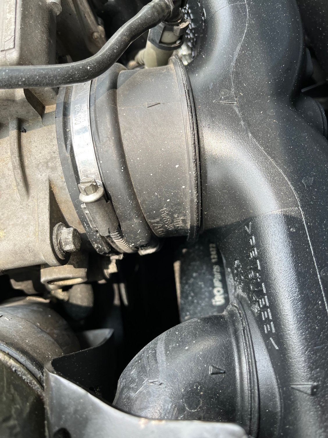

As an aside, just have look at the (inside) of air duct inlet to the throttle body where the clamping clips sits. I see you have a rubber collar on yours. Mine, on the 3.0SC AJ126S had cooked the plastic throat of the duct where the clamp sits. As 10mm from the water pump and rather hot apparently. Making the plastic hard brittle, and some flaking off leading to air leaking in. While you have the duct off, (as they say.)
Nice rubber boot over your one so my be OK.

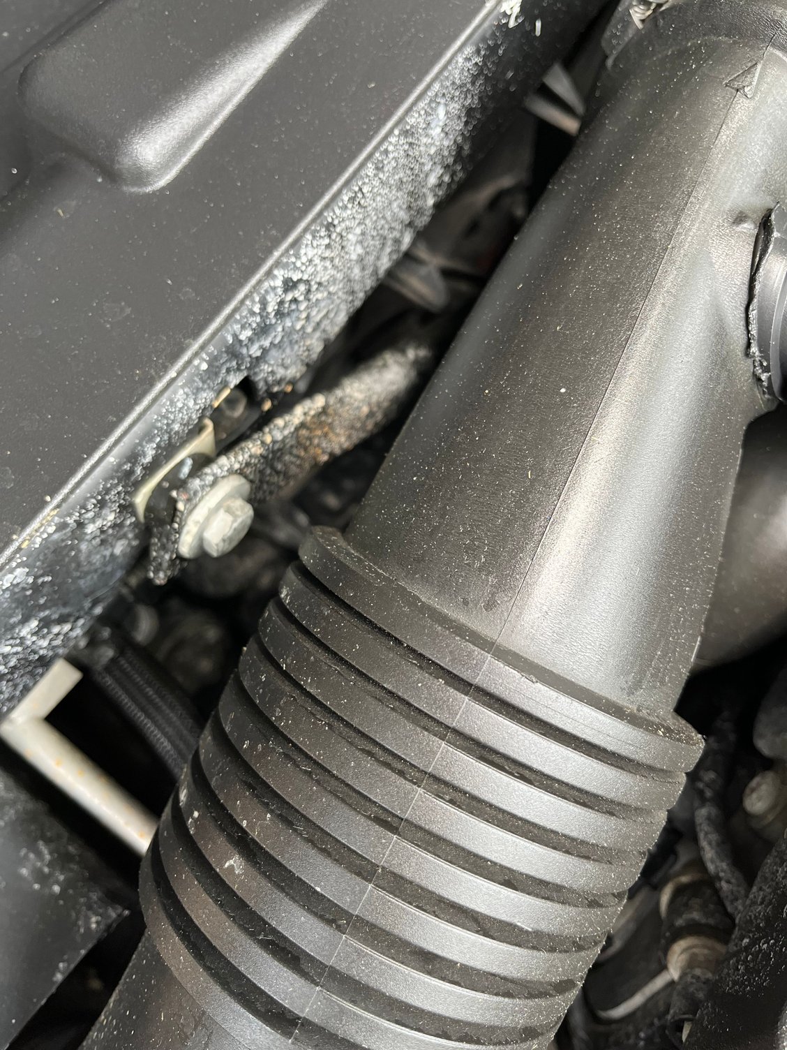

My son and I removed the air inlet duct to get a better look. We saw a small amount of coolant in the tray below the motor in the front of the car nearest the radiator. We attached a pressure tester to the coolant expansion tank. It held at 16 psi for several minutes without any dropping of the pressure. Unfortunately, neither of us could detect where there was a leak. This is an odd case where if the hood had been connected to the passenger cabin instead of front of the car we could have gotten closer to everything. Where I checked the water pump area was dry. I am hoping this means it might be minor at this point. We reinstalled the intake ducts and I will have to go with an auto shop I guess to look at it.

It is difficult to find the leak/ weep with the pressure test. The leaks like heat, hot engine and a bit of engine load and revs.
Sounds like it is the front of the engine, water pump from the tell tail, or the thermostat housing top cover seal leaking.
So long as there is no CW in the V of the engine it is less likely to be the forward cw pipes, or oil cooler.
Next best option is to remove the engine under tray take a spirited drive and put it up on ramps and look up from below to the water pump and thermostat area.
