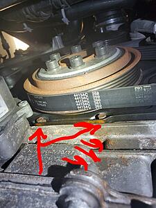

Saw a nice drip of coolant confirmed with low level in the res on my 2015 with 19,500miles. Pulled the skid plates off and got the best pics I could. First pic is directly under the water pump...getting warmer......

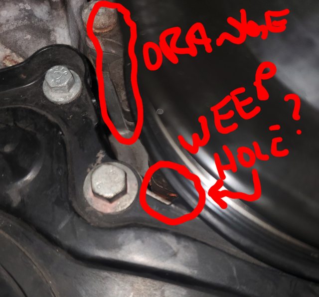

Second pic is what I believe to be the weep hole circled (which has new orange coolant coming out of it).
