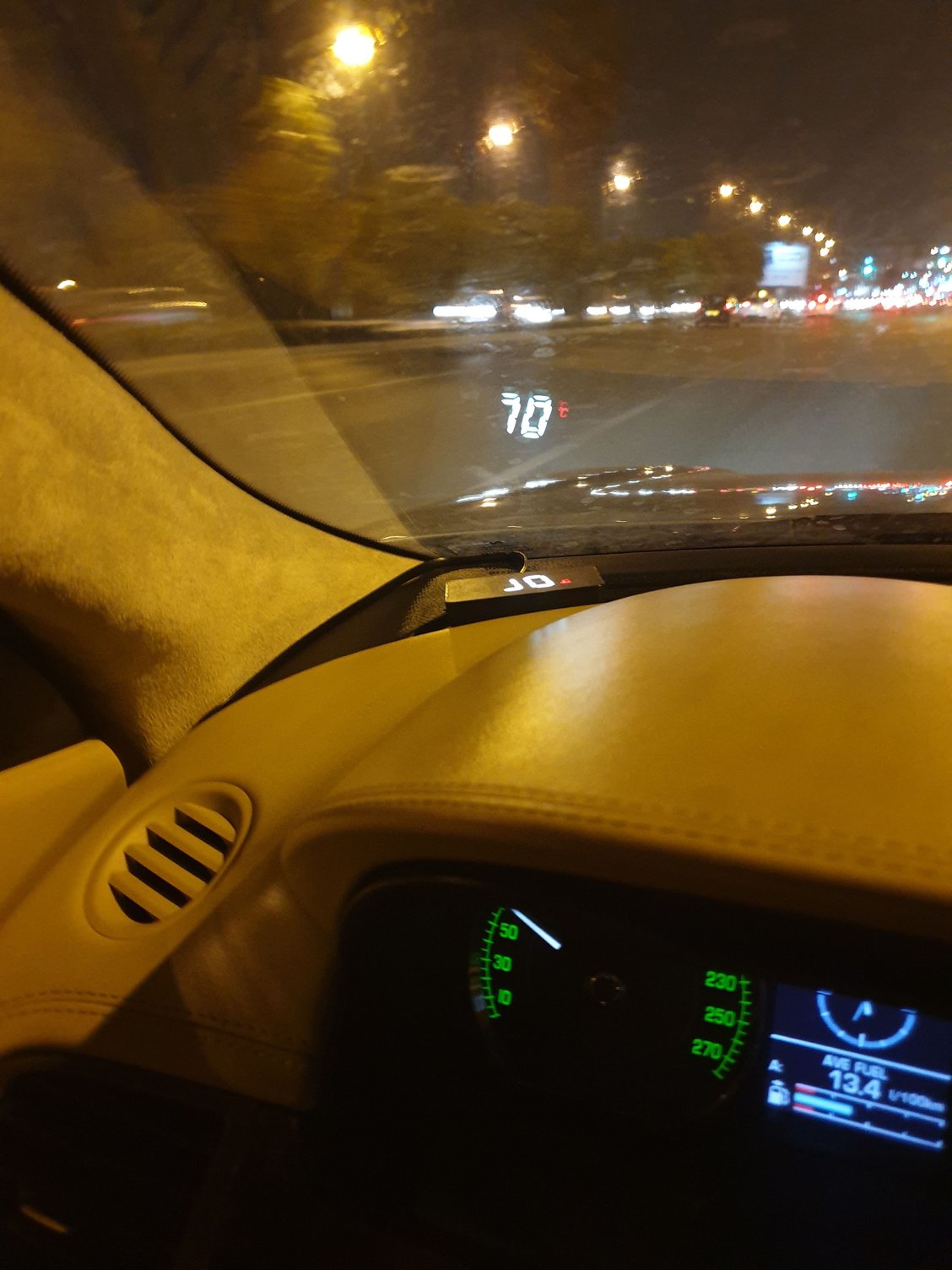

Originally Posted by Sean W
1) Buy one that automatically shuts down - I tried this and had to reboot it each time. It restarts itself but didn't pair unless you press the reset button. PIA..
I use this one. It shuts down and wakes up fine each time
