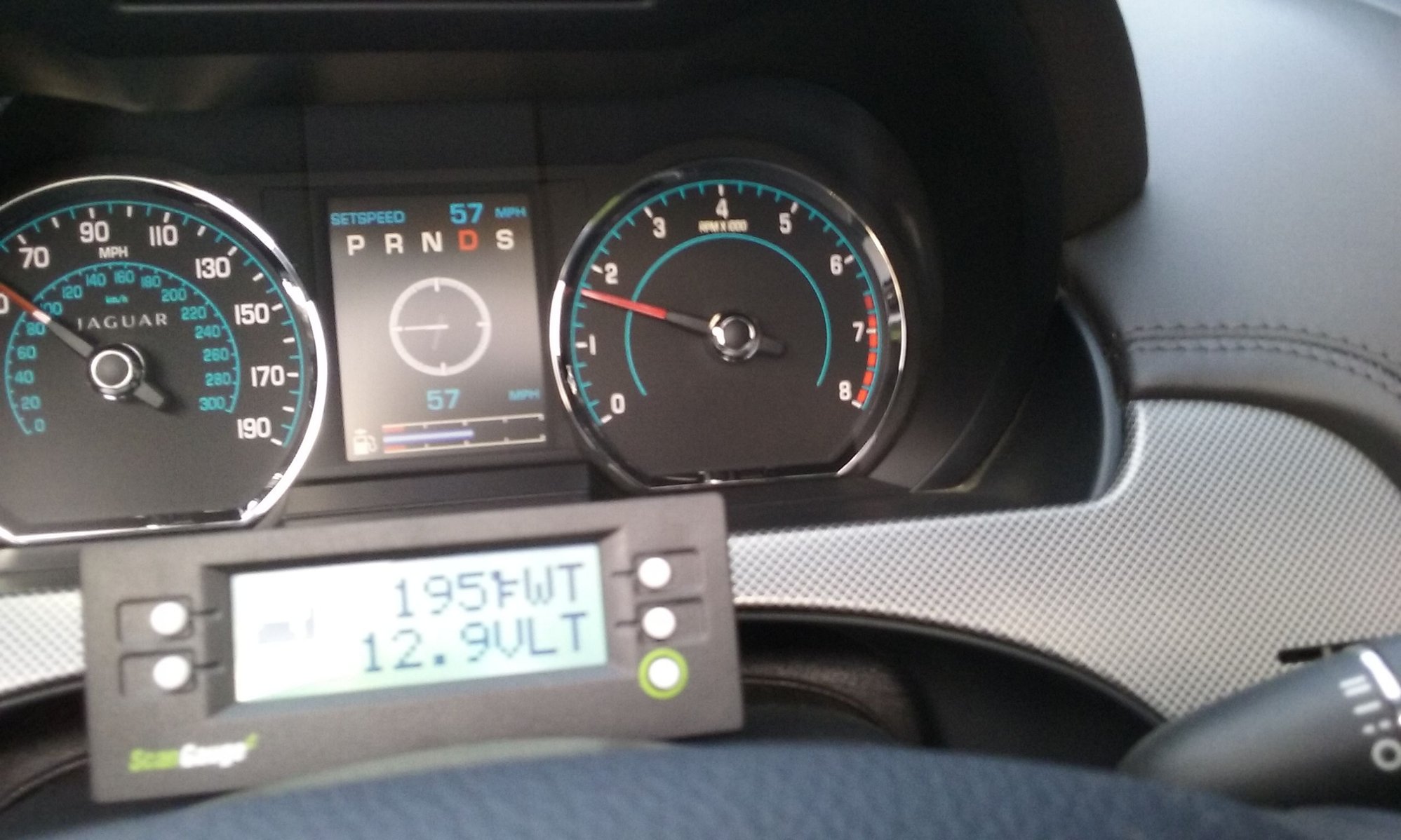

We took a drive this afternoon and the temp varied between 186 & 192 while driving. With the outside air temp at 84 it varied between 201 and 203 while sitting in a parking lot for 10 mins.....engine running.

I drove my ‘09 XK from home (west of Philadelphia) to Hampton/ Virginia Beach, VA via rt 13, Bay Bridge Tunnel, 285 miles. Temps ranged from 193 to 203. While stuck in a 5 mile traffic jam to get to the HRBT tunnel temps rose to 212-214. As soon as I got through the tunnel and traffic cleared, back to 193-195. No change in fluid levels.

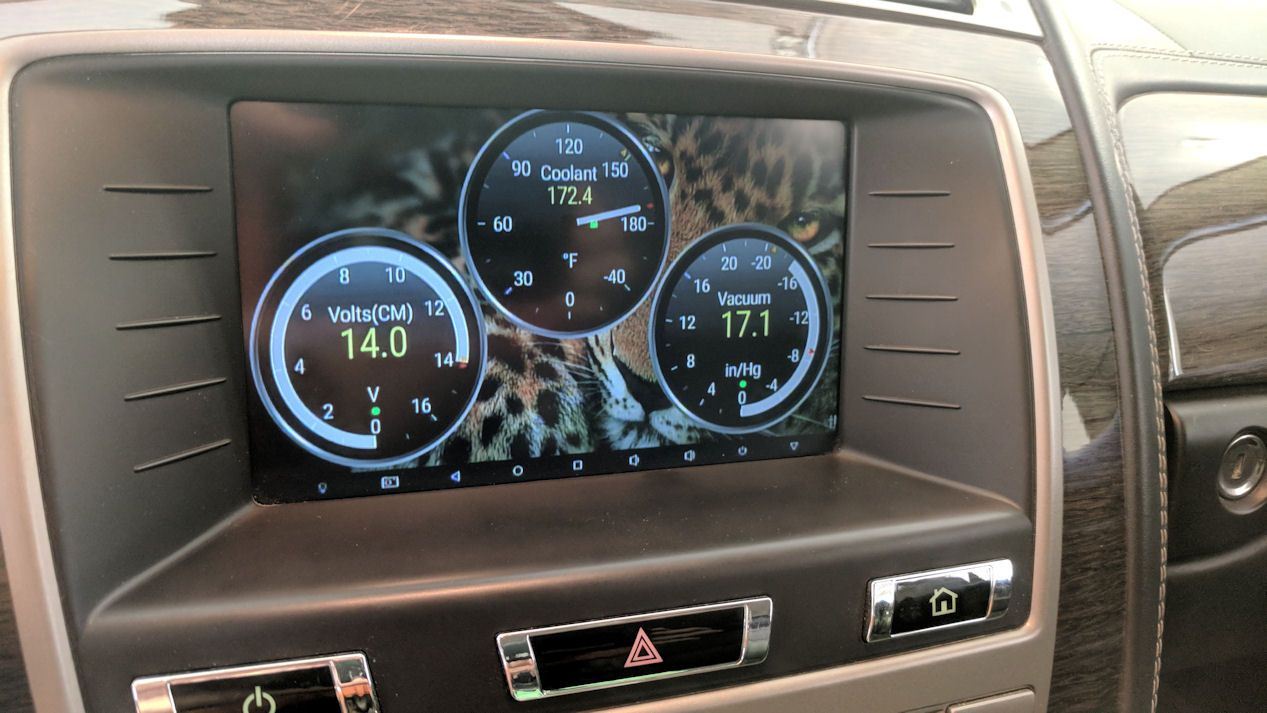

My gauges.......... linked to a Bluetooth OBD2 dongle using Torque Pro App;
You are my new hero and you absolutely have to tell me how you did this. I don't know if I'm allowed to say this, but I almost had an **gasm when I saw this.

Here you go:
https://www.jaguarforums.com/forum/x...-camp2-175877/

Yep, Sean was MY hero when I saw it.
..... I'll still take the dinner and scotch though................

I’m not as nimble as Sean. I use an OBD2 dongle that’s a bluetooth connection to an old 7” android tablet with Torque Pro on it.

Also, one bonus to doing that CAMP2 alternative is that you can do a near-OEM rear camera install at the same time since you're running wires and such. Course, the way the screen is done using a GVIF a person could also do it THAT way, but I prefer the zero-input camera, the way it was supposed to be. Lots of possibilities with a GVIF. Add the TV box and near limitless.

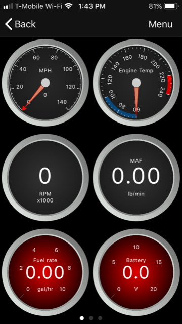

Originally Posted by Sean W
he was asking about an OBD device that interfaces with torque. Is that what yours is?
This is the device I used with my iPhone before I installed my HKS Camp-2 (for gauges and back-up camera):
https://www.amazon.com/gp/product/B00PFFG1EO/ref=ppx_yo_dt_b_asin_title_o07_s00?ie=UTF8&psc=1 https://www.amazon.com/gp/product/B00PFFG1EO/ref=ppx_yo_dt_b_asin_title_o07_s00?ie=UTF8&psc=1
It generates a wifi network, and I'd connect to it (if I was at home, my phone defaults to the house network, but easy to reselect the car network).
The device shuts down automatically, so no power drain. Don't recall any issues on start-up.
I didn't use Torque Pro, but I see there is an IOS version now. I used both 'Dash Command' and 'OBD Fusion' with no issues.
This is just the sample gauges from OBD Fusion, I don't have the device in the XK anymore, but keep it around for reading fault codes, and it also works fine with my Lexus and the wife's Mazda too:
