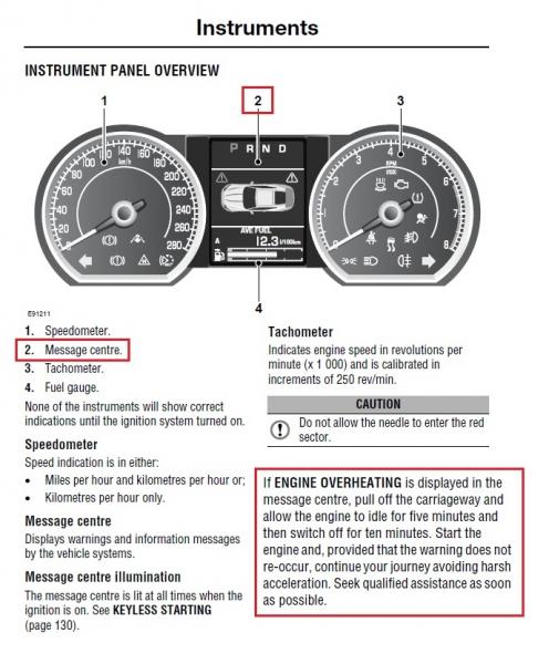

Old Jan 19, 2013 | 06:11 PM
Originally Posted by Hennie
................. I can't find any mention that the XK has any indicator of overheating or low coolant level! Please help!!!!!
I've checked the XK Driver's Handbook and it appears this is right. There is no Temperature Gauge or Low Coolant Level warning on this model. (owners please jump in and correct this if I've misinterpreted the manual)
The warning is limited to a FLUID LEVEL LOW warning in the MESSAGE CENTRE (see items boxed in red in the following extract from the Driver's Handbook):
This is probably because both the Temperature Gauge and the Low Coolant Level Sensor in the previous XK8/XKR and the XJ8/XJR were completely useless. By the time any warning appeared, the engine was already seriously overheated. Hopefully the XK/XKR warning is triggered more reliably.

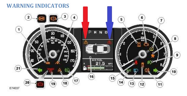

Old Jan 20, 2013 | 05:05 AM
Originally Posted by u102768
It looks like there are three temperature related warnings that could appear....................
So the TEMPERATURE HIGH warning illuminates the Amber Warning Triangle (arrowed in red in this graphic), OVERHEATING illuminates the Red Warning Triangle (arrowed in blue in the graphic) and there's also a message in the MESSAGE CENTRE (item 16 in the graphic)?
Provided the temperature at which these two warnings appear is accurate, that's a major improvement on the monitoring systems on previous models.
Where did you find the information?

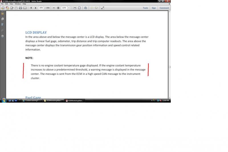

From the X150 Factory Workshop Manual.....electrical section, comes the two attached jpgs concerning coolant overtemp.
