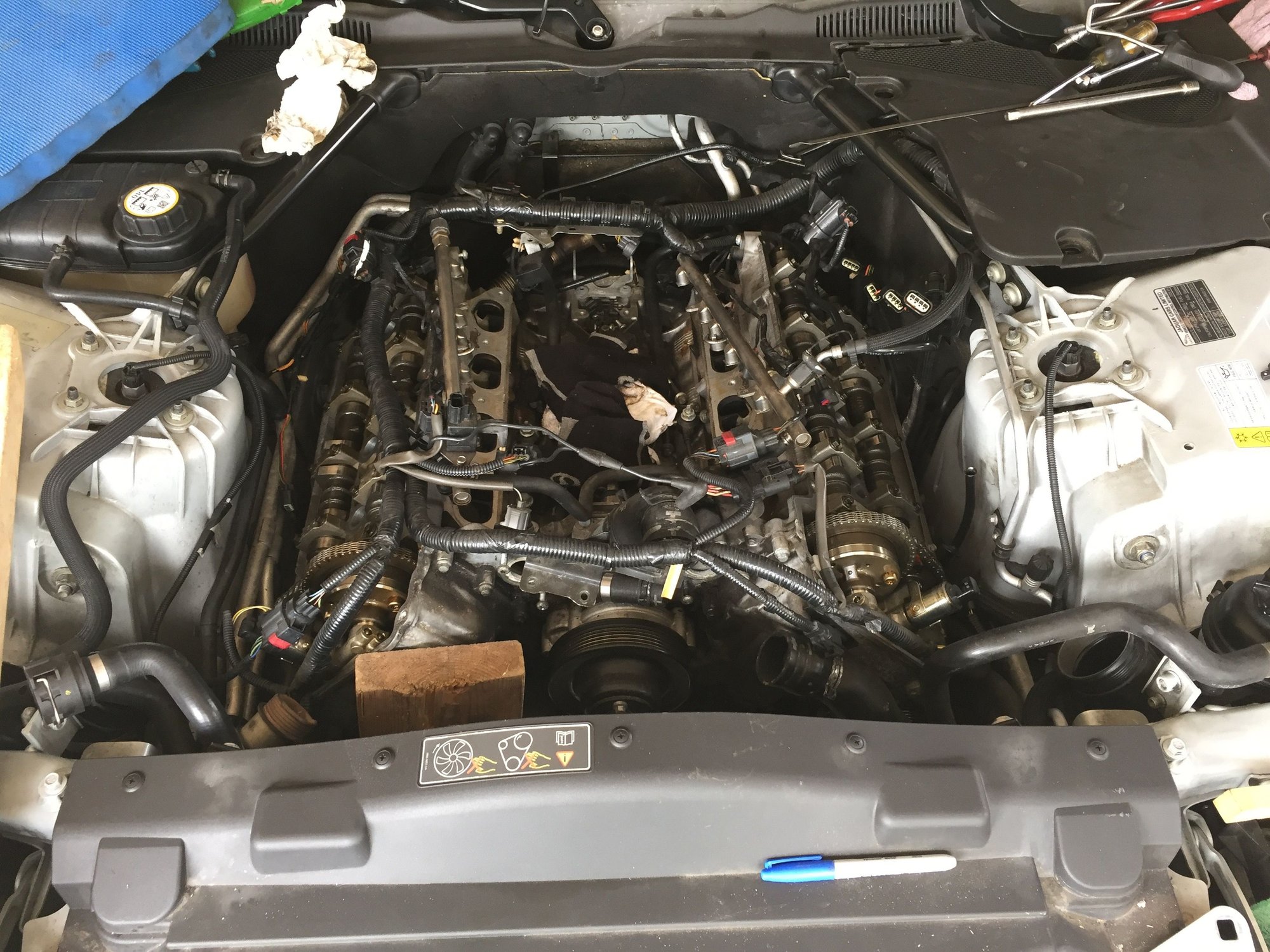

Very reluctantly I'm dismantling my 2008 XKR engine to take the heads off. (The RH one bubbled air into the coolant when I did a leak-down test on cylinders 5 and 7.)
Anyway, I've got as far as the crankshaft pulley removal and got stuck. I tried locking a wrench onto the nut and pulsing the starter motor but the wrench always comes off. I can't see exctly what's happening because I'm in the car, but I suspect the engine is torqueing upwards because the ratchet is jammed against the crossbar on the car's frame. I've tried jamming it in tight but the engine movement always throws it loose.
I can see the special tool listed for XK100's but the supercharged XK150 has two pulleys and is much deeper and the tool is $200! That's kinda crazy. Anyone want to loan me the tool or know a substitute?
And while I'm whining a little (it comes from having to face a head tear-down) I've noticed broadly speaking that there's lots of articles and parts listed for XK's up to 2003 or so, but then it gets quiet and the 2007 to 2009 XK150 cars have much, much less for them in DIY's and after market parts.
I guess the XK150 crowd polish the door mirrors but they let someone else open the hood!
Mark
The point where you wished you'd been more careful when buying your latest car!

I guess I spoke too soon. The crankshaft pulley bolt is out but the pulley is firmly attached and won't budge.
I made up a tool from a puller that I already had, but it just bends sideways once I have it cranked up tight.
I tried knocking around the pulley with a hammer while it was under tension, but no joy.
I even tried applying a little heat. I didn't have the right length M8 outer bolts apart from some aluminium ones, and of course one snapped.
Then I made my shorter steel bolts connect but it was a terrible tricky operation because I'm leaning over the front with no space down there and still no joy.
Are there any tricks? Yeh, I know go buy the correct puller for $200.
My puller modified with angle iron
