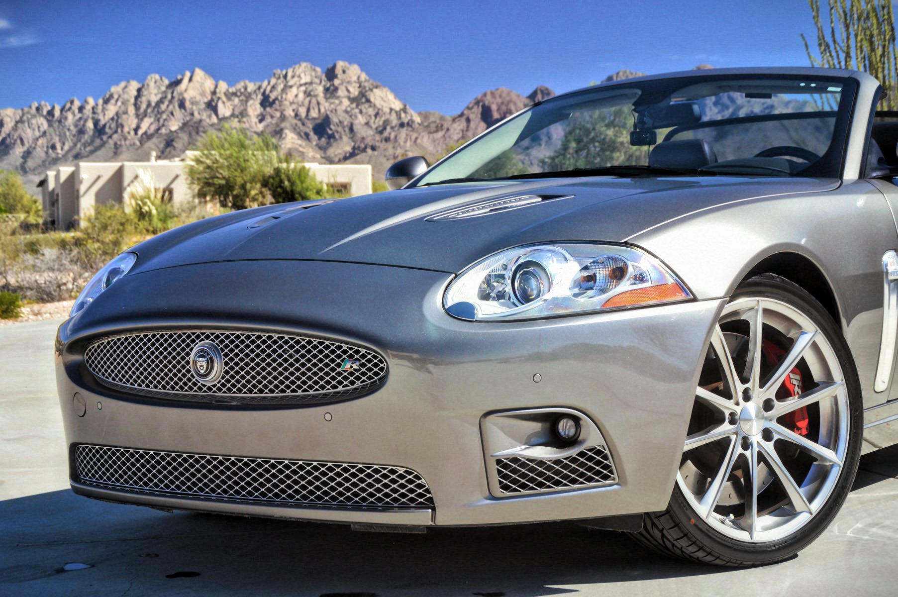

The grille is genuine OEM Jaguar and was the same on 2007, 2008, & 2009.
Below is an image of my 2009 front & grille.
Although the price was $10,500 you will have plenty of work and expense to bring this XKR up to a better quality ride. Repairs will not be cheap. I don't believe you mentioned the mileage. I would think you're looking at another $10,000+ to bring the XKR up a greatly improved condition.
New paint alone will probably run $8000+ for a good quality paint job if done correctly. It will be the small stuff that really adds up very fast on these cars.
With these XKR's you really get what you pay for.
Click the image to enlarge.
