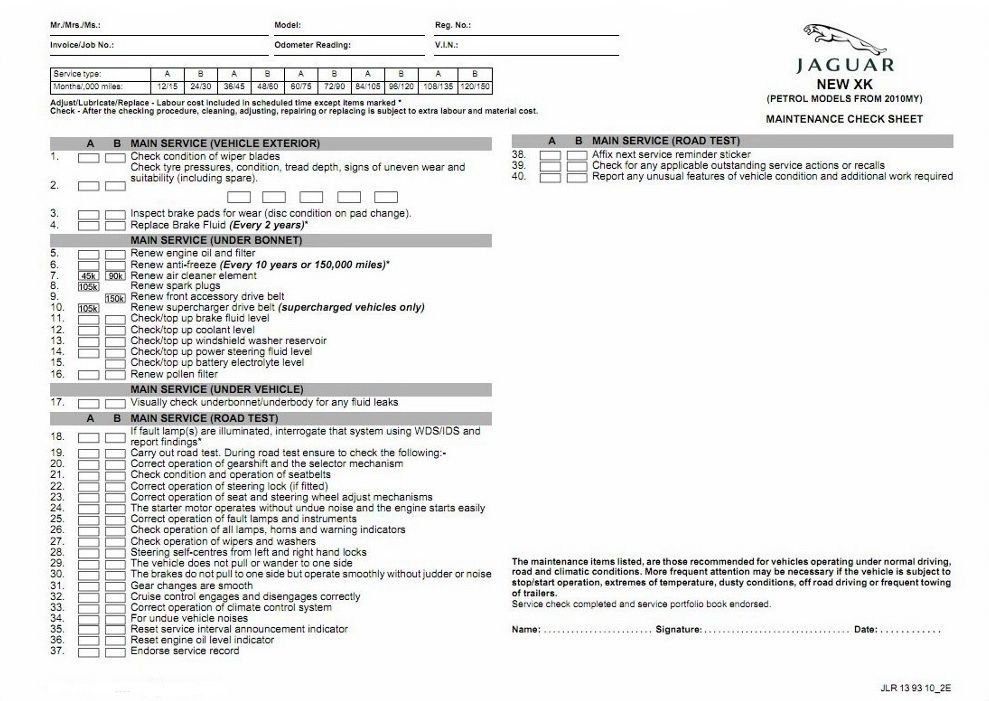

I like to change ALL fluids on a "new to me" Jaguar. Regardless of what it shows in the Service History, this then gives me a known base point for future maintenance and picks up on anything which may have been overlooked.
Here's the Maintenance Check Sheet for 2010 Model Year:
Note that the recommended service interval is 15K Miles OR 12 Months - whichever comes sooner.

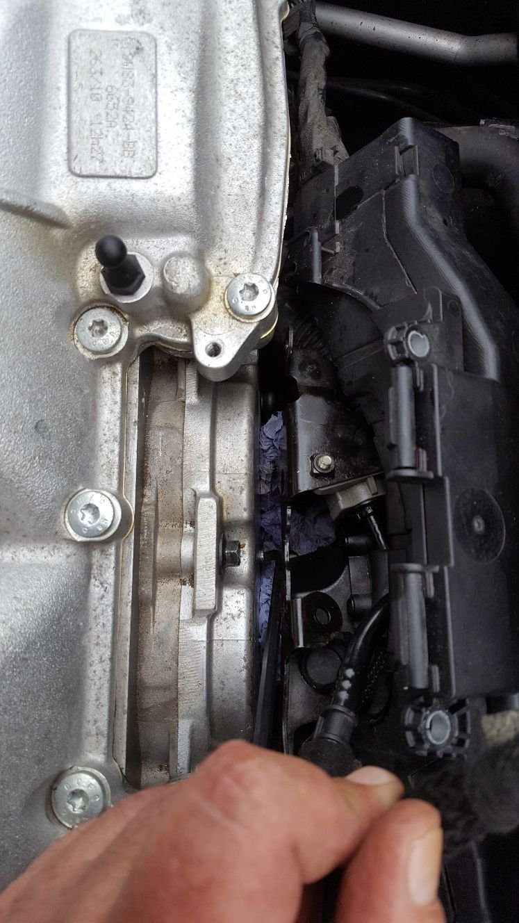

I forgot about the Diff oil change sure it cost under £200 . Yes sure it was only £110-145 . without checking files . its an easy job to do so i am informed . Yes i have also done a Diy on the supercharged oil change not easy on the 5l cars . sure its in the stickies or maybe some one can point you in the right direction i took photos

Old oil is like gunk and Real smelly . Fill drain plug /grommet is down the gap in last photo just before the blue paper towels i put in to catch any oil or in case i dropped the plug you will see it slightly protruding from allen key
