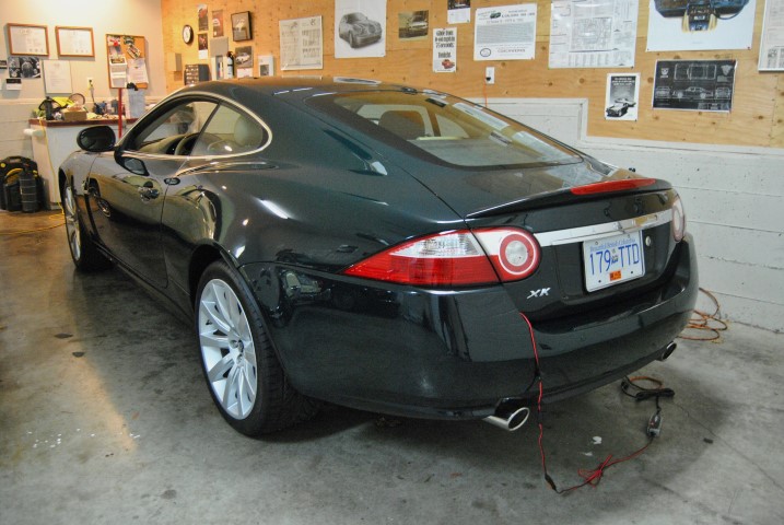

I can tell you from experience with CTEK chargers that the LEAST expensive unit (the one I use on all my cars is the US800) is perfectly adequate - meaning perfectly good) for desulphating and keeping at full charge any Jaguar battery so that there are never any electronic issues with the cars. The CTEK units are reliable and very, very sensitive to any drop in voltage. Just pressing the lock button on my XK sends the CTEK into action. The unit must be kept outside the car so that you can monitor how it is working - and for that the "comfort extension" is needed. when you want to drive the Jag you simply disconnect and off you go. The CTEK can be left in operation for months a a time. I have used them for years.
Attached Thumbnails CTEK Battery Charger 5.0 mxs-xk-british-racing-green-005-small-.jpg
