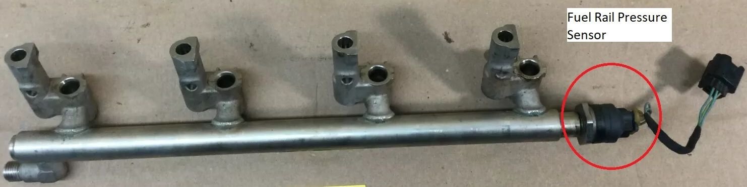

Yes the fuel pressure sensor is removable and we found out later that it is also a fuel temperature sensor. That's not documented very well in the manuals.
This is off my 2014 XJR. Which should be the same as your car.
The electrical connection is just a standard push tab to release connector. They are difficult sometimes and of course the lovely position it's in on the engine makes it darn near impossible to get at! As my picture shows removing the passenger side fuel rail makes it simple. But that's a LOT of work if the only thing your doing is replacing the sensor!
