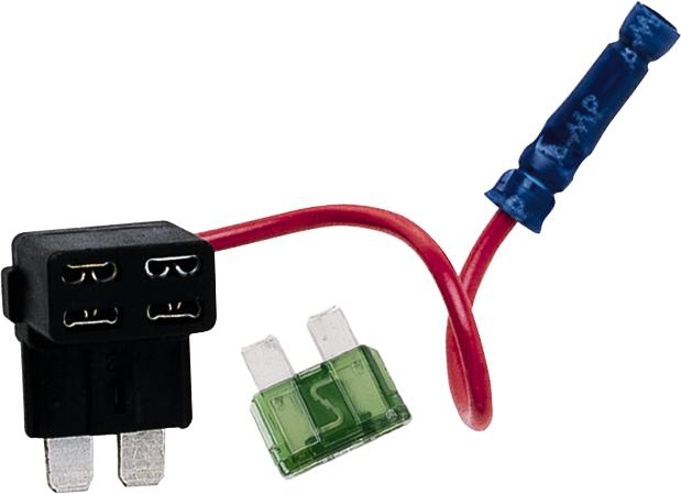

I would run the power leads for your camera into the fuse box. Find a terminal that is powered when the ignition is on and tap into there. This is how I used to wire all my radar detectors. I know you said you did not want to "hardwire" it,..so maybe this is not an option. But, aside from you cigarette lighter, I don't know of too many other options.
I just used some electrical blade connectors to do the job, but you could use a fuse tap product like this one.
I like this idea and have never seen these before. Thanks so much for making us aware of this product and thanks so much for the photo.
