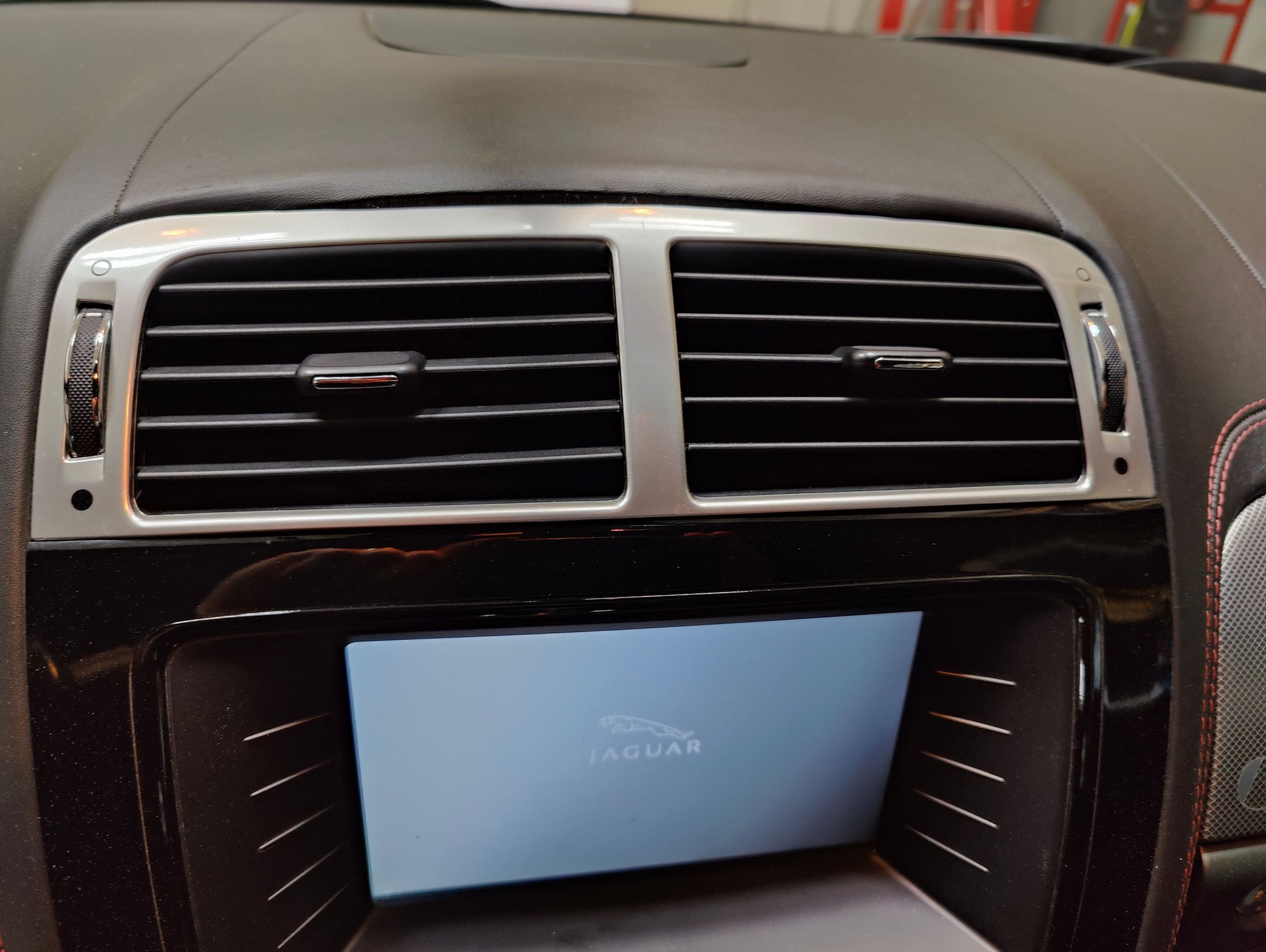

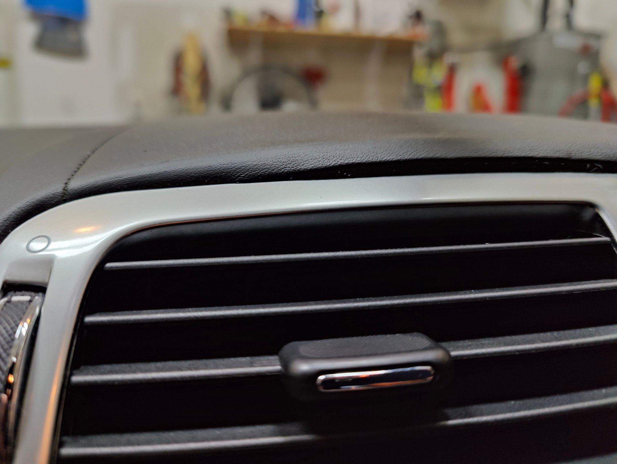

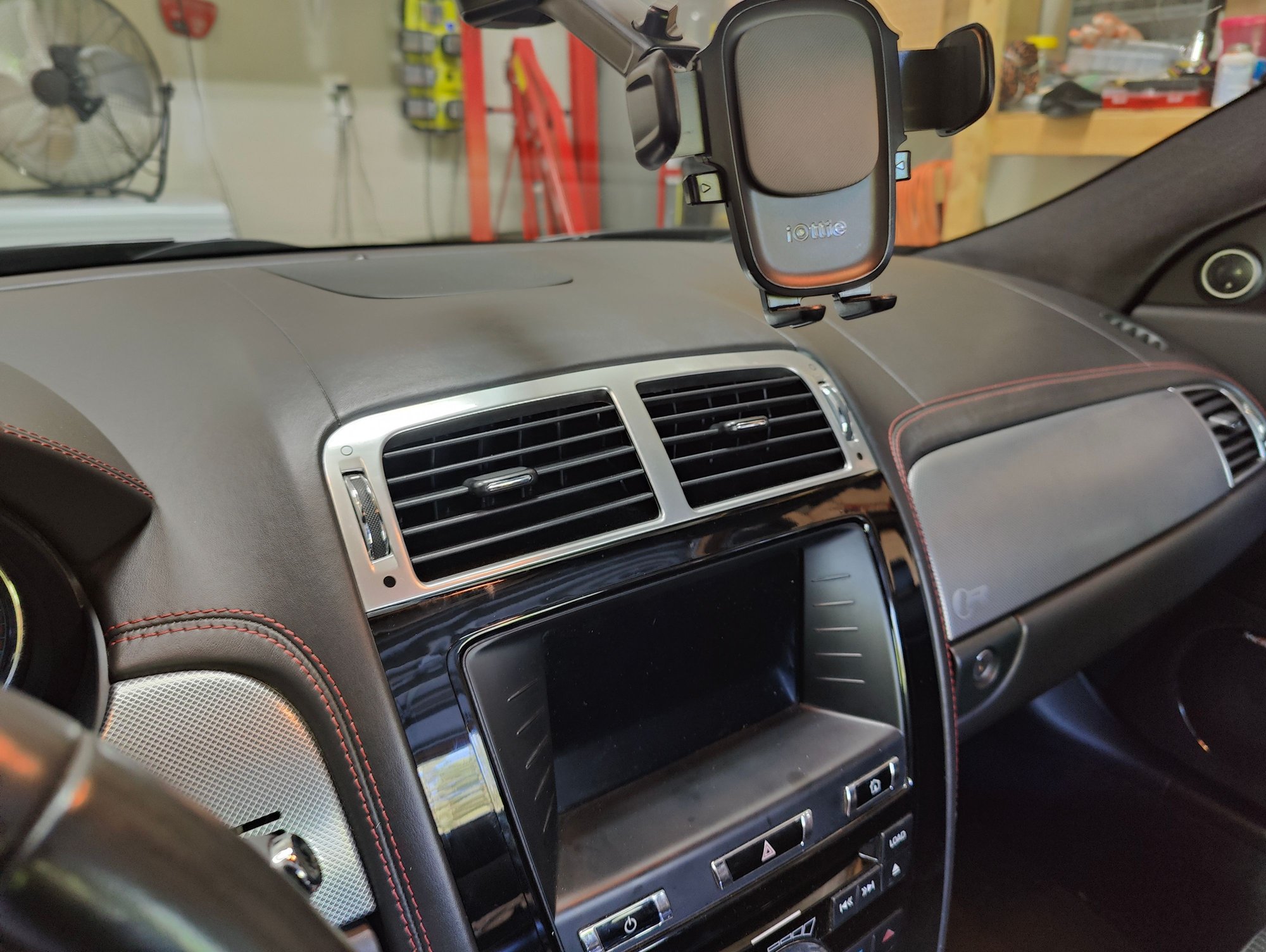

As you can see in the pics, the leather just above my center vent is sitting above the vent (see pics).
I can't tell if the dash is slightly warped there (heat?) or whether the leather has pulled a bit as these are known to do.
I saw another XKR with the same problem for sale a few months ago so I know mine isn't the only one.
Has anyone on here had this issue and resolved it? If so, what did you do?
Thanks in advance!

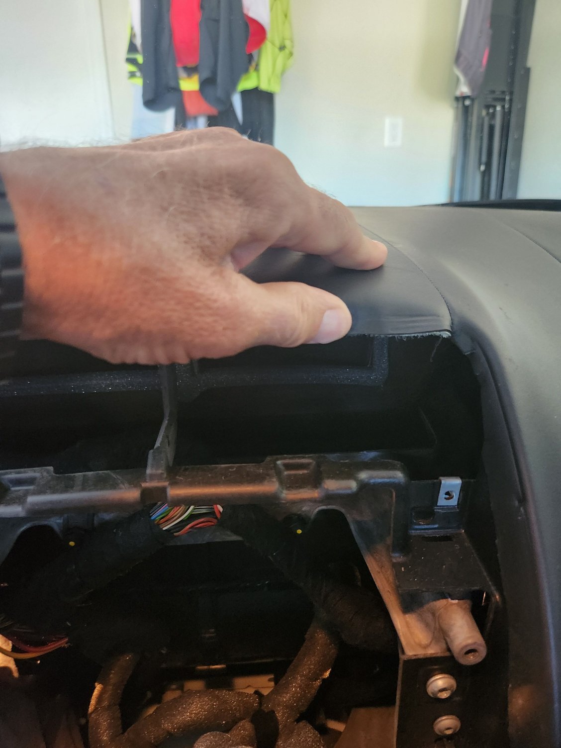

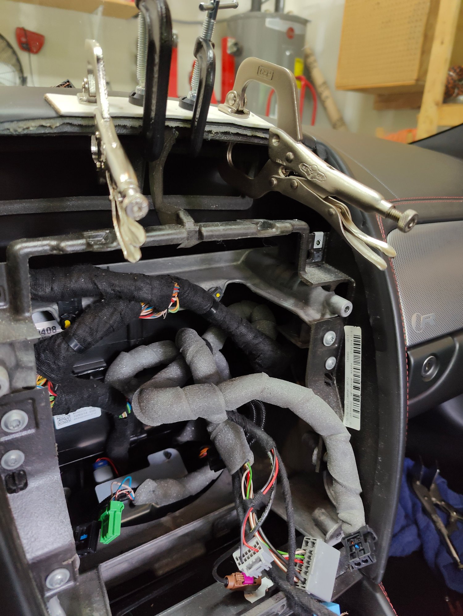

I wanted to follow up on this post with a big "Thank You" to @kenbowen for sharing the procedure he used to resolve this issue.
I followed his instructions and they worked perfectly. Like him, couldn't get quite enough room to staple the edges but since my car is garaged and doesn't spend too much time in the sun I am hopeful that the glue (Weldwood Contact Cement) will hold up for a while.
I spent a solid week conditioning the leather and then I stretched it over three days.
I used sheet metal vise grips with a thick piece of dense cardboard to grab the leather and clamped it using c-clamp vise grips while I pulled on them to stretch it. Then I would leave it stretched and clamped for about 24 hours before doing the same thing again. After the third day I had enough room to glue it down.
Before gluing the edge, I lifted the loose section up and went as far back as I could (toward the speaker) with contact cement. I glued that part down, let it set for a few hours, and then did the last couple of inches at the front.
I am happy with the final results and the best part was that it was not necessary to pull the dash.

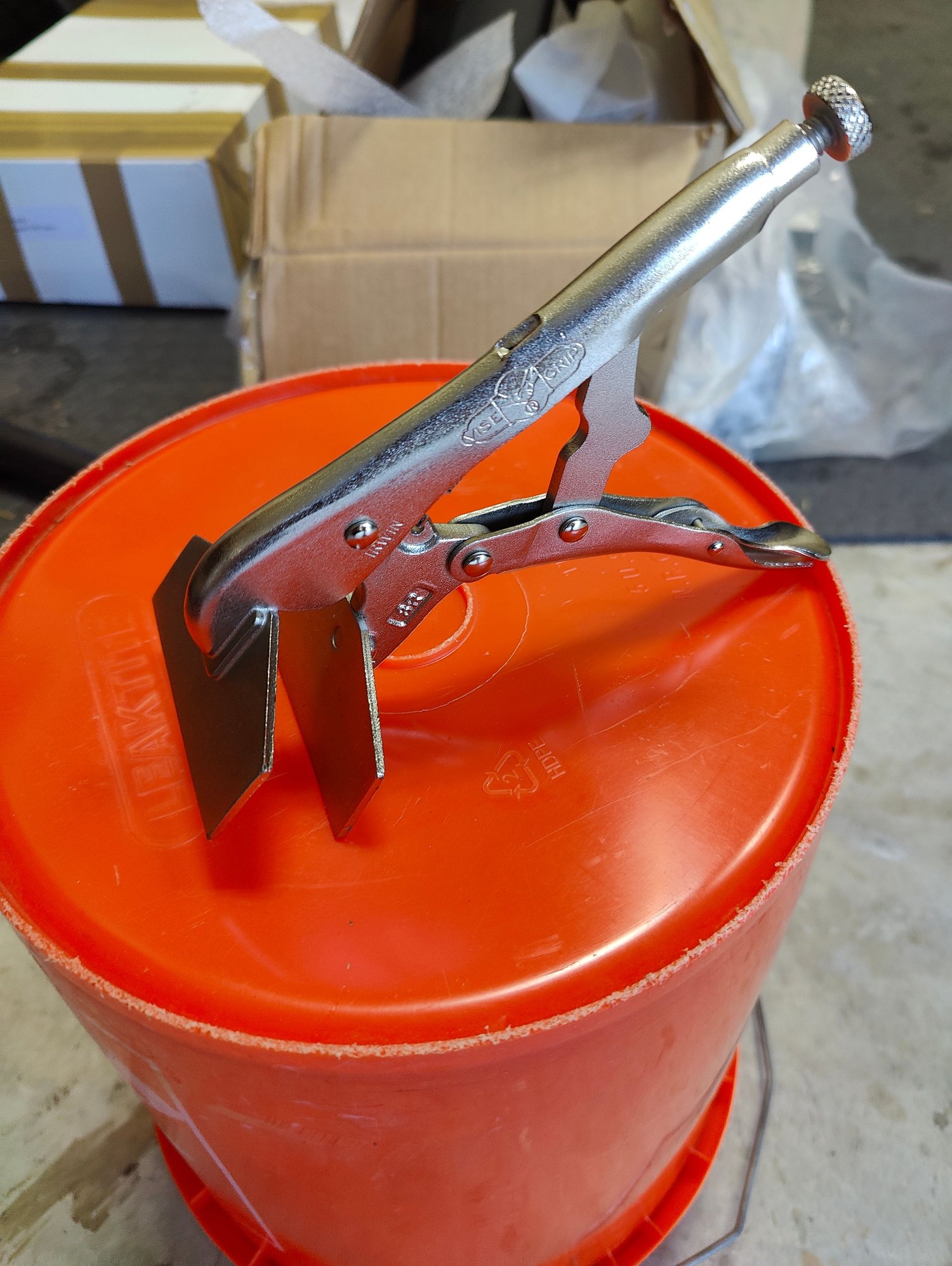

Just finished this repair on my 09 two months ago. Here are a few pointers:
1. Start by applying liberal amounts of leather moisturizer or mink oil to the area between the speaker grill and the vent multiple times over a period of days.
2. In order to remove the air vent you will have to remove the wood trim as well as pulling the head unit away from the center mount. You should still be able to keep everything in the head unit hooked up which is the much safer route versus full removal.
3. Get some wide vice grips and use wood popsicle sticks on both sides of the leather and apply moderate pulling force all the way across the top multiple times over a period of time in order to give it a chance to stretch.
4. I then used contact adhesive to reglue. I stretched it just enough to get it to cover under the vent but did not manage to staple it so I am hoping it will last a couple of years with the new glue.
PM me if you want a photo of the completed job. It's nice to get it done since it is visually in about the worst spot imaginable.

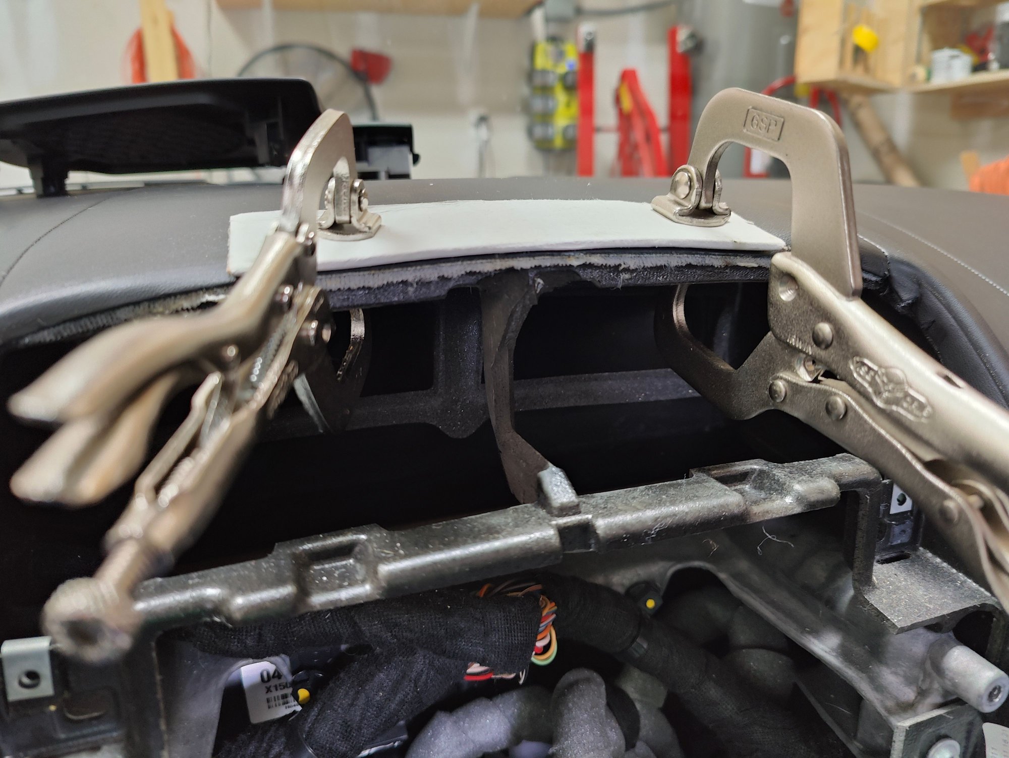

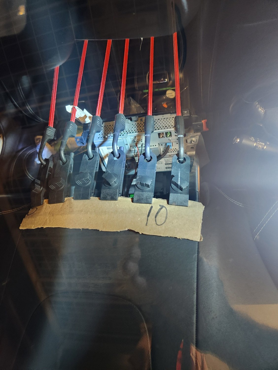

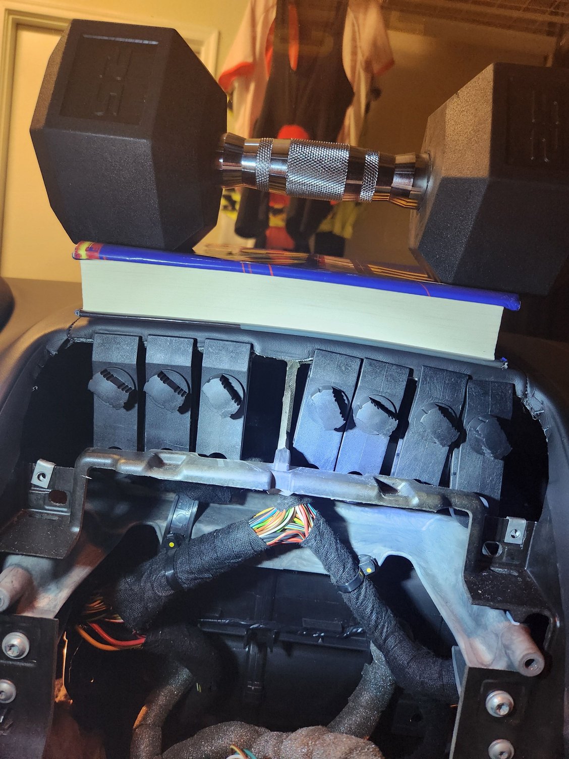

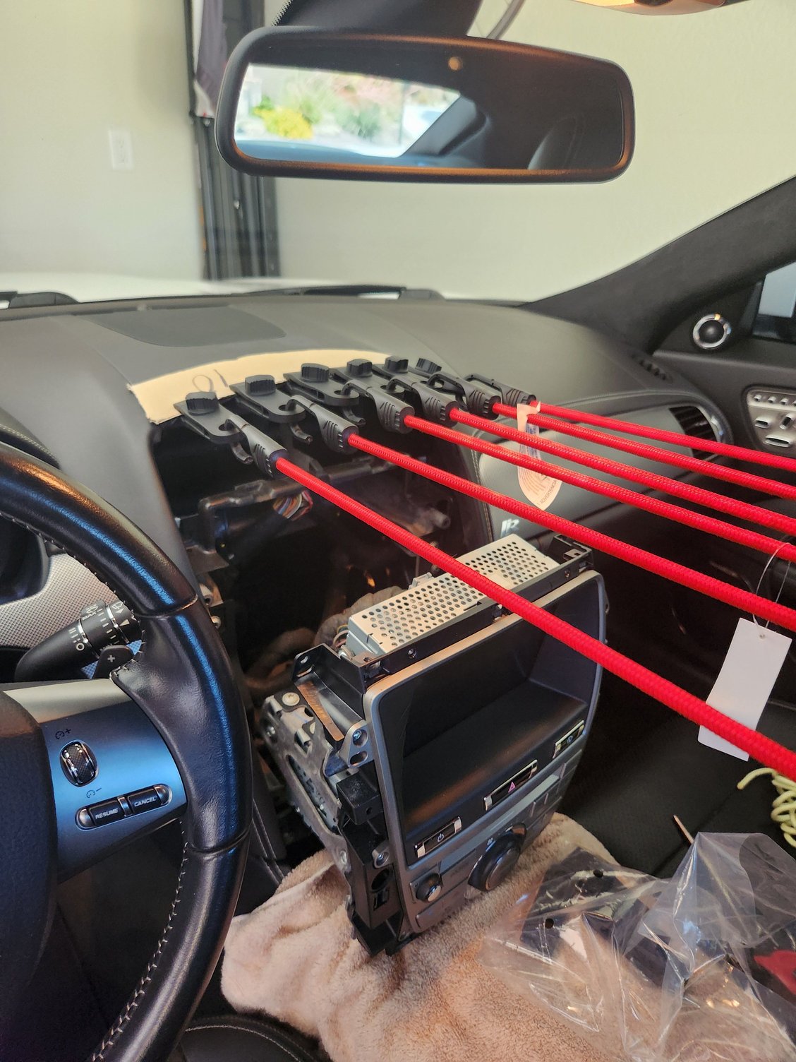

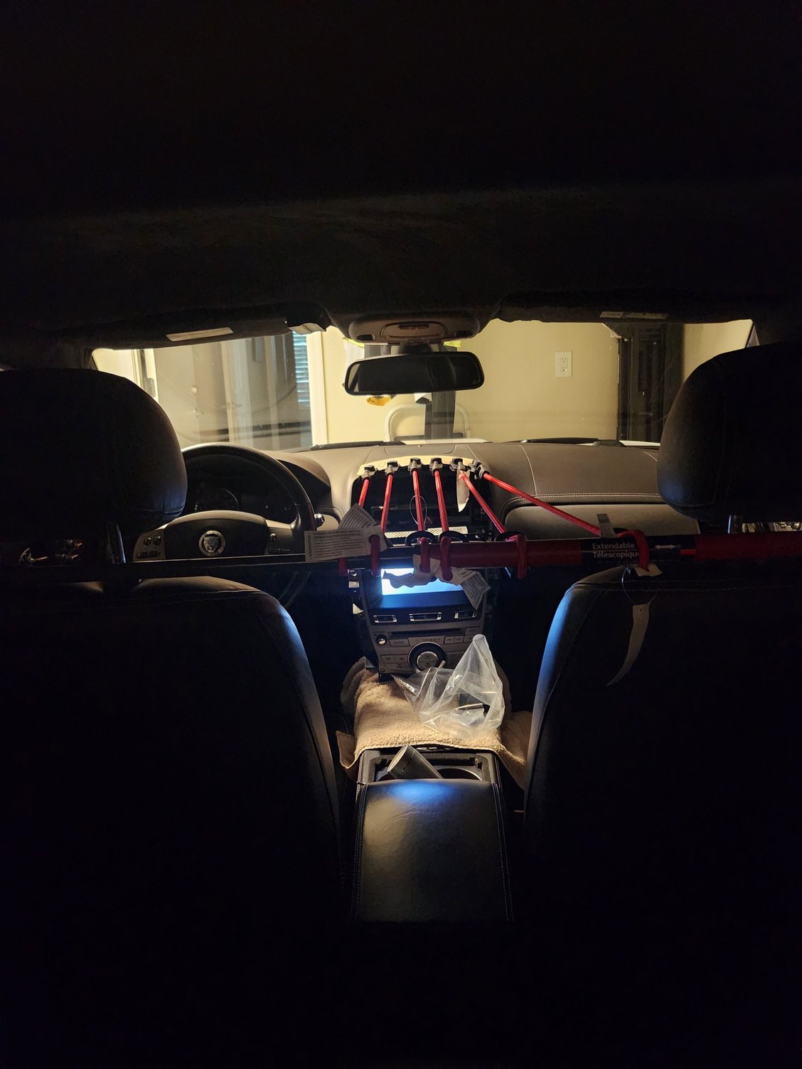

I have/had the same condition. Here's how I fixed it. I soaked a microfiber towel with water and placed it on top of the area. I let it soak for several hours. I pulled on the area after soaking and found it was stretching. I had purchased some "tarp clamps" off Amazon, some leather glue, and 6, 24" , bungee cords. I attached 6 clamps to the leather. I attached a bungee cord to each clamp. I moved my seats all the way forward and upright. I put a pole behind the headrests and stretched the bungee cords to the pole and secured them. I moved the seats back to put tension on the cords. I left it like this overnight. I checked the cords several times during that time and moved the seats to add more tension.
in the morning I found the leather to he stretched as much and more than I needed to fold over the dash. The leather was dry and I removed the clamps.
I applied leather contact cement according to directions and folded the leather into place. I probably had more than Jaguar originally had used. I placed a book on top of the dash area and put a 25# weight on top of it. The book conformed to the dash arch. I used the claps along the fold and left it for 24 hours.
Now as good or better than new.
Clamps and bungees
Adding tension with the seats
Clamps attached to the leather. Used cardboar under them to avoind the clamp marks
Let the stretching begin and continue
Stretched more than enough to fix
Glued, weighted, and clamped
