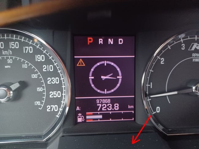

I know rattles can be infuriating and often difficult to track down; mine has an intermittent buzz (depending on road texture and generally only at very high speeds) that I thought was located somewhere under the dash. Nope, It is from the plastic covering of the instrument panel. Putting my hand on it stops the vibration and hence the noise. All it is needs is some sort of shimming or wedge to firm-up its location. (On the off chance, just thought I'd offer that experience)
Best of luck.
