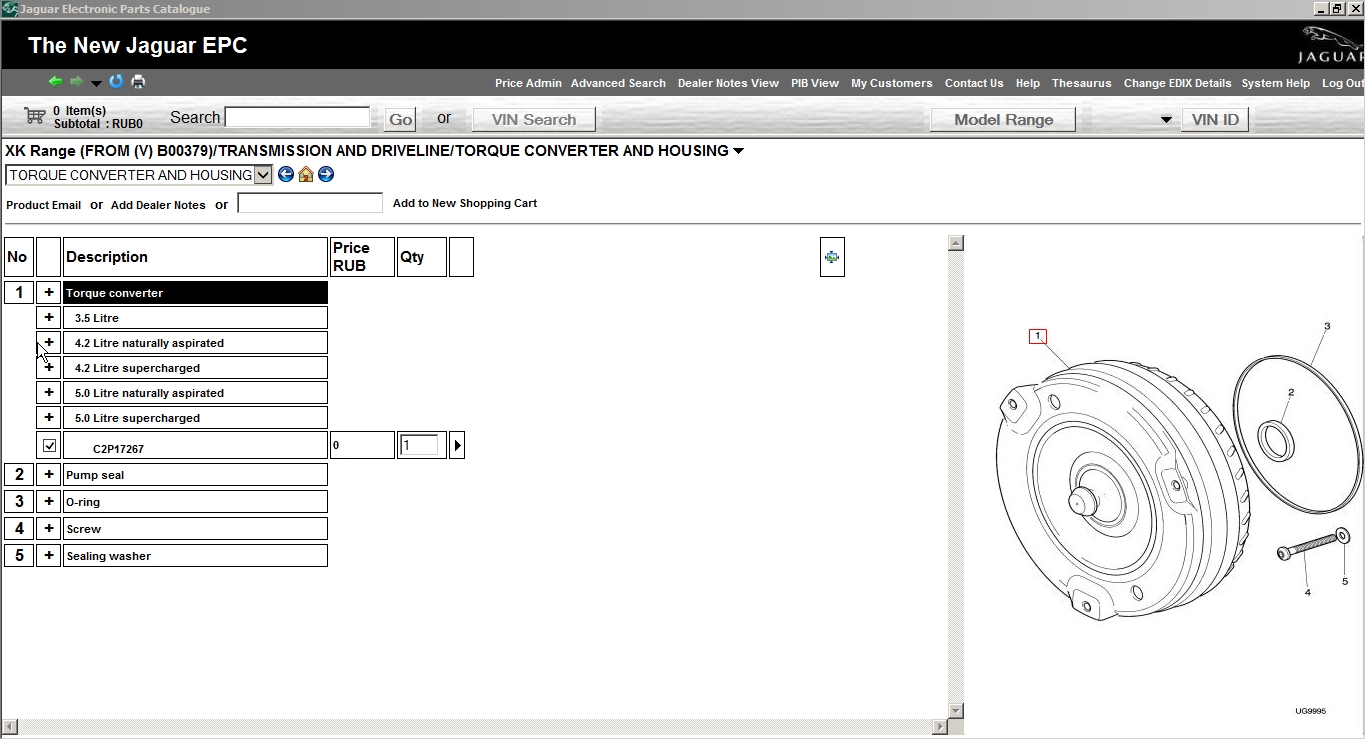

There is only one torque converter for the supercharged 5.0L
DGL and Cambo arguing about XKR-S, XKR75, Dynamic Packs, etc...-screen-shot-01-31-17-01.50-pm.jpg
There is no special TCM file for the 5.0L XKR-S, if it existed you can be damn sure we would have flashed it into the same XKR's that we've put the XKR-S engine tune into... it's a myth, or at best a marketing gag. It doesn't exist.
I accept what you're saying about the Dynamic Pack option as shown in your documentation. But the torque converter and TCM in the XKR-S is not unique, it's the same as regular XKR's, and same in the XKR-S GT as well, we have scanned an XKR-S with the SDD diagnostic system and checked all the software versions.

Okay.... I understand you want facts, I prefer facts too. I prefer to get my facts first hand or directly from JLR Tech Support, not the internet.
Please get a VIN for an XKR-S or an XKR75 and try to order one of these "special" torque converters. You cannot order one, because they do not exist.
Please plug an XKR-S into the SDD diagnostic system and report back with the calibration ID of the TCM, it's the same as a regular XKR, because there is no special TCM program for it.
I've done both these things, I know what the answers are.
Now, if you think about what's been claimed from a marketing spindoctor point of view, there is a certain element of truth to this about the transmission program.
The PCM is the primary driver for how the transmission behaves, the PCM tells the TCM when to shift up, and when to kick down. The XKR-S PCM tune is more aggressive than a regular XKR here, especially the kickdown. So with the XKR-S engine tune, you get a more aggressive transmission to boot. From a marketing perspective "the recalibrated transmission" is kind of true, given that it's actually controlled by the PCM, which certainly was recalibrated.
I've reflashed several XKR's with the XKR-S tune (also the F-Type V8S with the F-Type R tune) and yep, the transmission is much more aggressive with the higher power tunes. So it's kind of true, but has nothing to due with the TCM...
