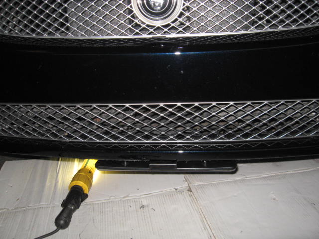

edit: oh almost forgot....bought one of the hideaway front license plate holders...when the plate is up will it be disrupting airflow and cause a cooling problem?

Originally Posted by Goodryke1959
I used the obd at auto zone and yes, it was loose gas cap. Should the cel go off eventually after driving it a bit? The guy at auto zone said on some older cars you have to disconnect the battery to recycle the cel to off. Doesn't disconnecting the battery cause some settings loss?
Thank you,
Jeff
07 xkr
Nope, reference hideaway tag. In the lower grill area there are oil coolers on either side. I placed my "hideaway" in the center......not been a problem, at least on my '08.
