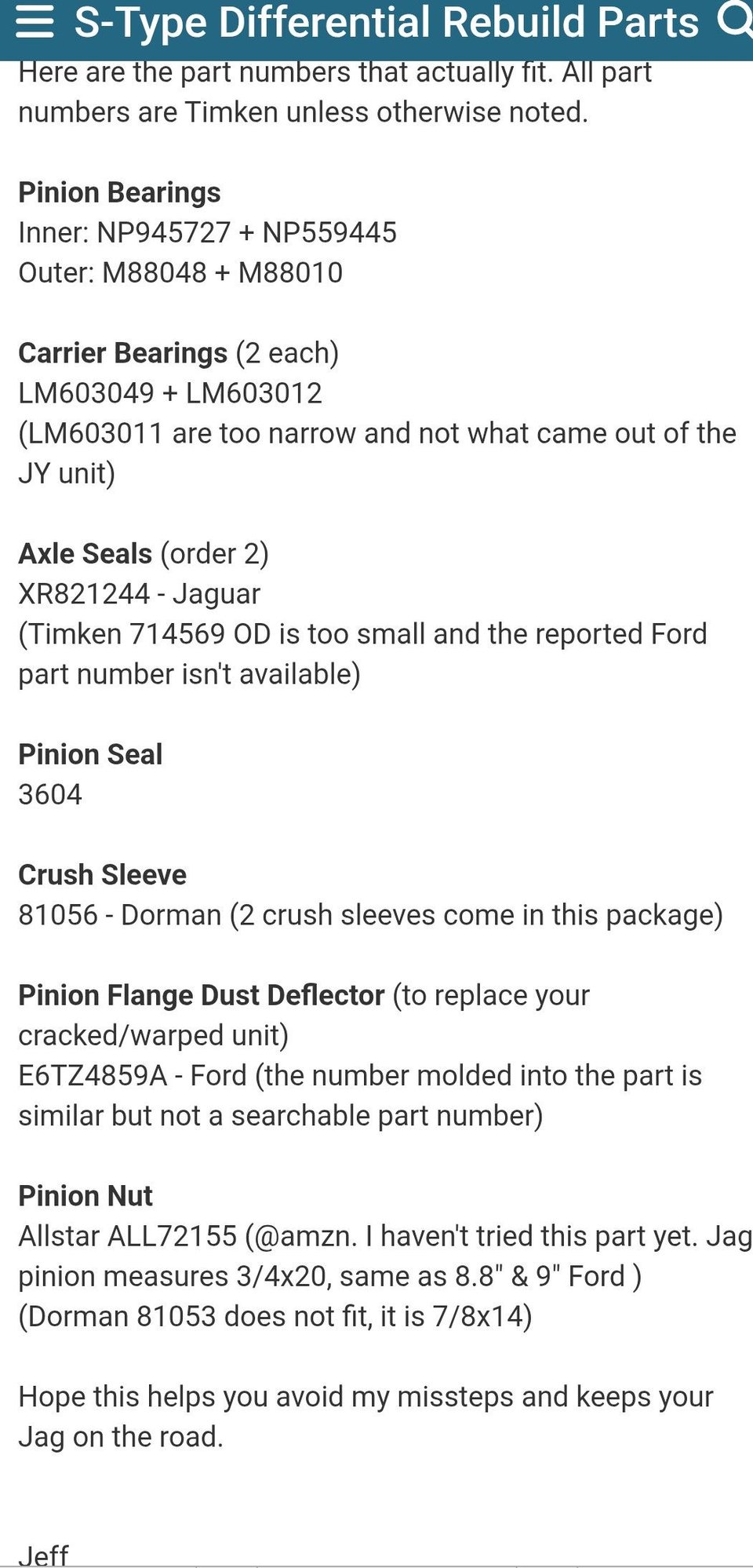

Currently rebuilding my gen 2 differential xk 2007-2009 looking for parts numbers for all the bearings/seal (carrier and both pinon bearings) also the crush washer & snap ring whilst im at it
Can anyone help with this ??

Incidentally, you may find the part numbers you are looking for in this thread: https://www.jaguarforums.com/forum/x...arings-102296/

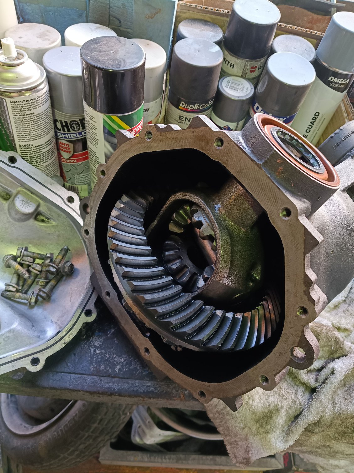

Differential stripped and components cleaned just waiting on seals & bearings to arrive from the U S

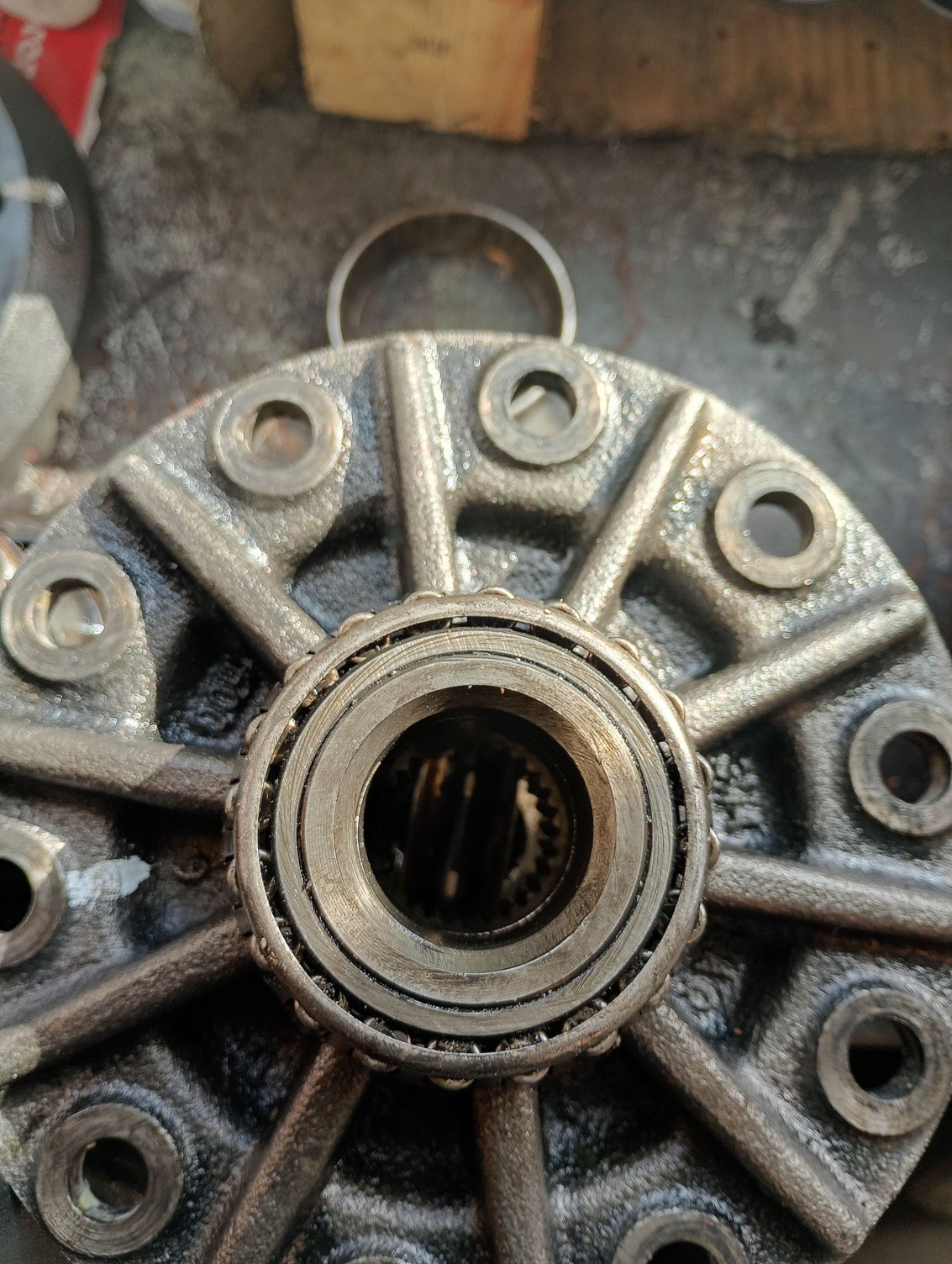

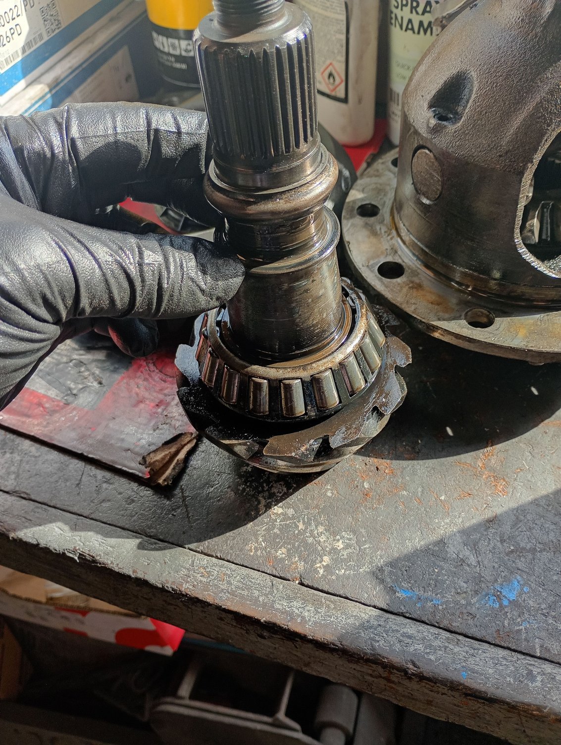

Finally got around to putting this back together - pinon peload set on the new bearings
Just have carrier bearing cap to torque down - can someone help me out on torque specs normally it's around 100nm but I can't find anything

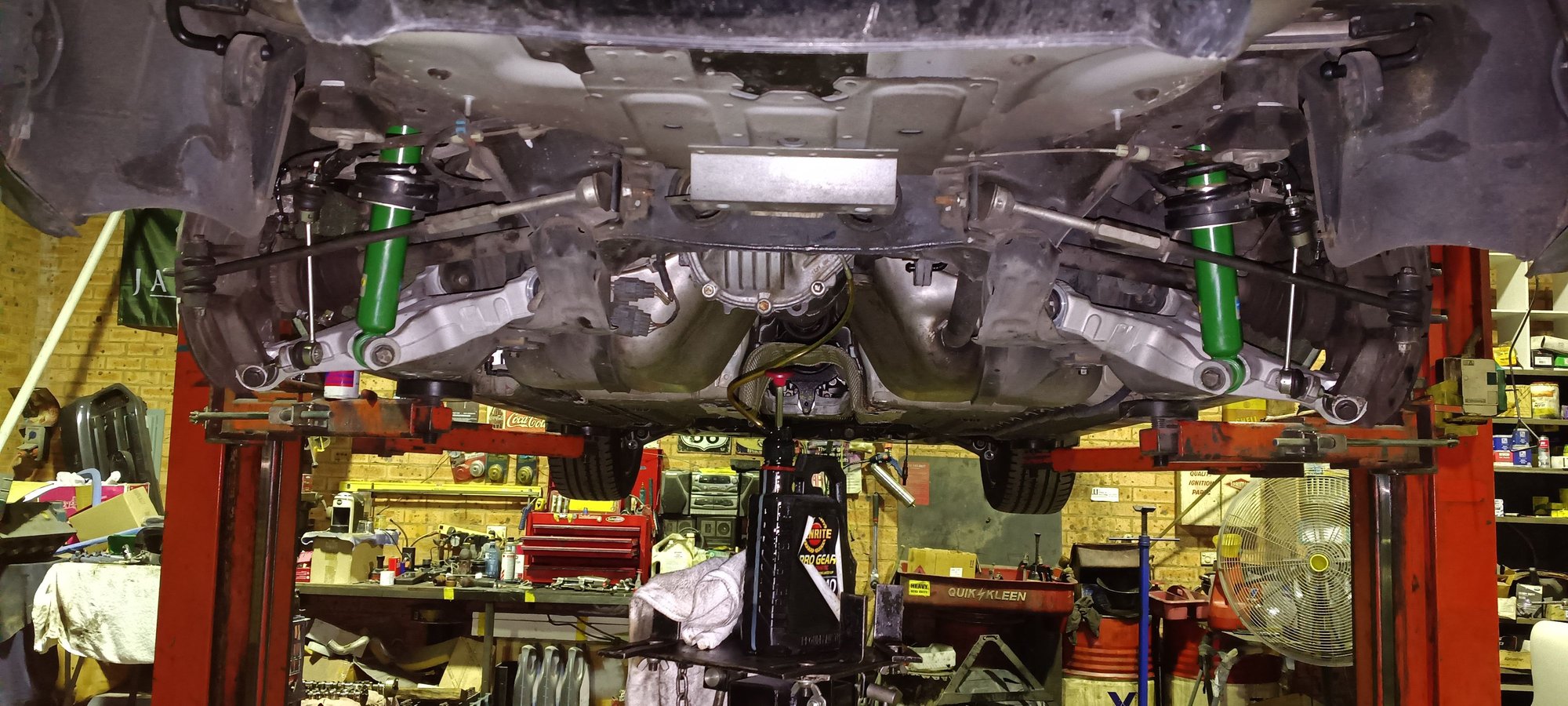

Rebuilt 3.58 diff finally swapped out today (the OEM diff was caked up looking very nasty) ..everything seems to be good filled it up with 80-140 and looking to run it in over the next 2 weeks
