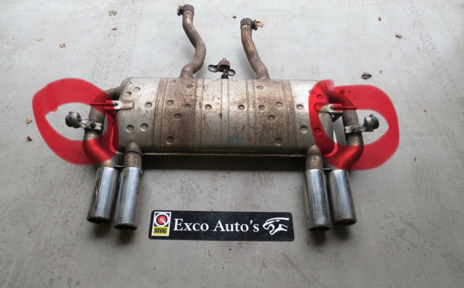

The Oder XKR must have had modified exhaust. The XKR-S should snarl and pop somewhat. Check to make sure the muffler bypass valves are not stuck closed.

How would one check the bypass valves?

Your rear muffler should look something like this. The red circled thingies are the bypass valves. They are vacuum operated. They need vacuum and the engine running, to close them. At idle, and when the dynamic feature is engaged they open. So, the easiest way to confirm they are opening is to feel if exhaust is coming out of the outer pipes, with the dynamic feature engaged.
First off, pull fuse #19 behind the center rear seat. Fuse 19 provides the power to CLOSE the valves using vacuum. They should always be open with no electrical power supplied.
With the engine running, hold your hand over the outer-most tail pipes. If the valves are closed, those won't have air flow. To assist, have a helper rev the engine a bit more to produce more exhaust.
