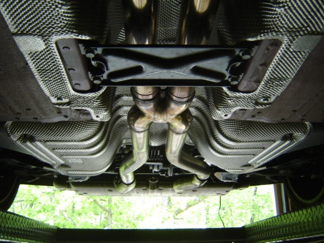

If the XKR came with the Performance Active Exhaust (PAE) then it has an X pipe not an H. I believe the XKR-S has the same system so the back box would be the same.
Attached Thumbnails Exact difference between XKR and XKRS Exhaust-dsc00092.jpg

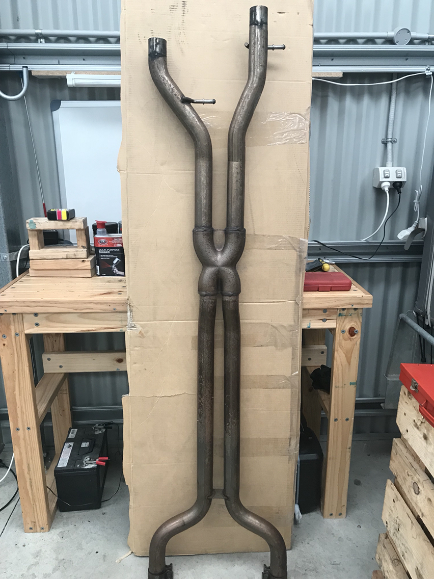

XKR-S centre pipe
XKR-S rear muffler
The differences to the centre pipe are obvious.
The XKR-S rear muffler has larger diameter pipes coming out of it, larger valves, larger tips which are polished. Internally they are different as well, it's open inside with one of the pipes removed, the other pipes being larger than the standard XKR one.
The 5.0 XK, XKR and XKR-S centre pipes and rear mufflers are all interchangeable, same diameters, same fitment. You can put an XKR-S rear muffler on an XK, the XKR-S centre pipe bolts up to the standard XKR rear muffler, etc

Originally Posted by multistrada74
is that pic of the stock XKRS exhaust?
That is a picture of my 2012 XKR with the PAE option. It does not come with the twin in line mufflers but only the rear back box with the vacuum operated outside pipes. I assume this is the same as the XKR-S .

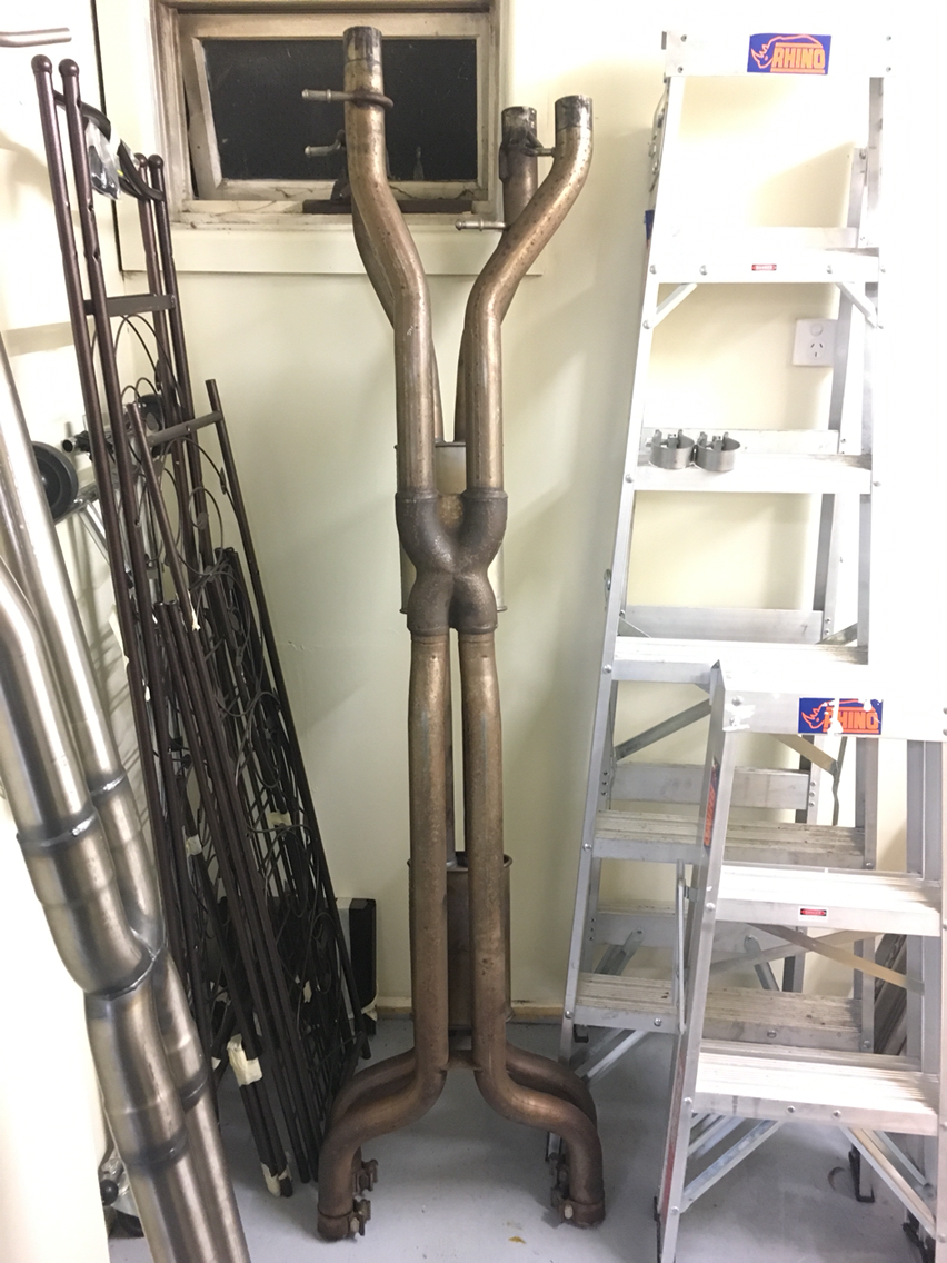

My friend dropped off the XKR-S pipe last night, here you can see it with my stock 4.2L XKR centre pipe.
I don't have a regular 5.0L centre pipe here to compare it with.

Originally Posted by Cambo
That I couldn't tell you, I haven't seen inside the two cans on the centre pipe.
Some people have put the XK centre pipe on an XKR, and reported an improvement in the sound, there's a thread here in the forum "XK exhaust on XKR is win" or something like that. The XK centre pipe only has the rear can on it.
Attachment 205908
interesting and tnx for that pic.
my 5.0 2nd can (closest to the rear axle) looks much different than both on the 4.2. my first can by the cats looks exactly like the 4.2 first can.
