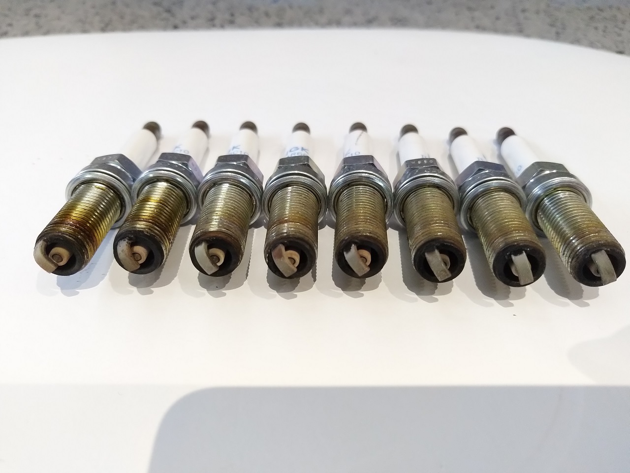

Had a look at the old plugs, the tips all look about the same colour and that appears to be OK so I guess no cause for concern with the engine. The two on the left came from the rear-most cylinders, bit darker discolouration round the threads there but I guess they're closest to the oil drains for the PCV system. The fifth one from the left has a nasty crack on it but that one took a lot of force to remove so probably cracked on removal.

Old May 8, 2020 | 05:57 PM
George05's Avatar
Joined: Aug 2019
Posts: 1,361
Likes: 418
From: London
Look good

@8bit . How many miles on those plugs? They look pretty good.

Can't remember exactly (I generally have the DIS display to show remaining range) but a little under 60k miles, certainly no more than that.

Wow. I haven't changed a set of plugs in ages-- but those look fine to me! They'd go into a coffee can with a little solvent and then a lite wire brush, and good to go.
