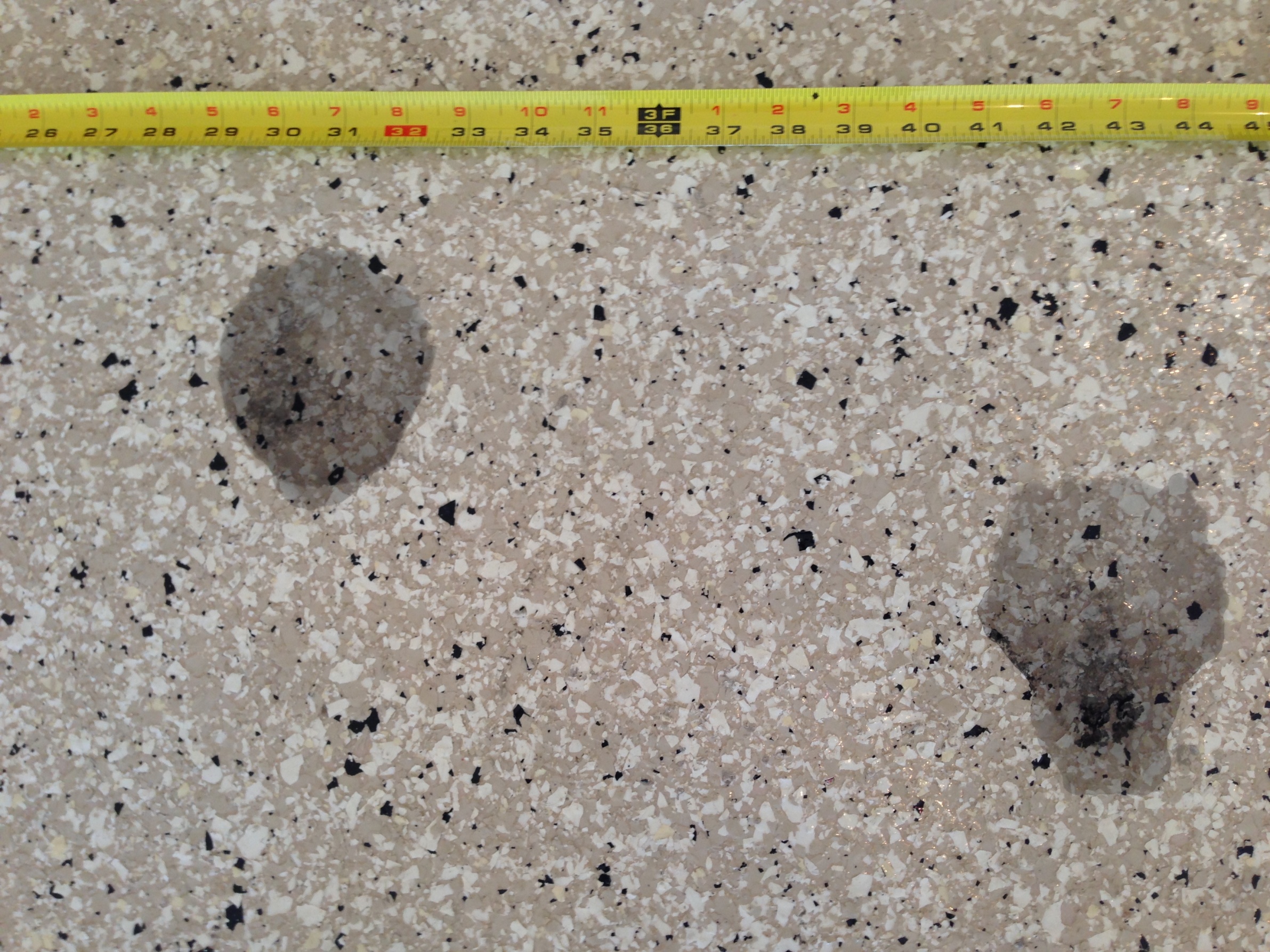

OK, it is a small issue, but.......
On my 2012 XKR-S over the last several months I have noted two small (3" diameter) stains on my garage floor. While they are easily cleaned up they are irksome none the less.
Investigation revealed that it was from water leaking from the exhaust pipes at the point where they are clamped together just under the rear suspension.
On the just completed 36 month service (20k mile) I took the attached photos to the dealer, explained the issue, and received the following (seemingly very condescending to me) response on the (no charge) invoice: "No fault found. This is normal operation of a combustion engine as the gases combust and get released from the vehicles catalyst as temperatures cool the stream that is leaving the exhaust condenses down to a liquid which is what the customer is seeing. This is completely normal operation of all combustion engines."
I understand the basic point of water as a by product of combustion, but feel that it should not be leaking from the exhaust system in this way, but rather exiting as vapor thru the tail pipes. Am I way off base? Do others have this same issue? Would you complain to the service manager? Thanks for any advice.

I have the identical black stain marks at the rear exhaust where it connects over the differential. I noticed it when I purchased the car 8 months ago in PA in the winter. I had the car up on the lift and noticed the black water collecting where the exhaust pipes connected and a few drops on the floor. I questioned the service writer to make sure there were clamps in place and that they were tight. I don't get any dripping once I got the car back to Florida due to the heat and lack of condensation. To me I don't think it's a big deal, but I agree that the pipes should be tight enough to keep the condensation from leaking anywhere other than the tailpipes.

If big molecules of water are able to leak, aren't exhaust gases even more likely to leak ahead of the rear mufflers? Doesn't seem right to me.

That was my first thought.... I would think that you could get a muffler shop to disassemble and use an exhaust paste on the joints.
It could be self sealing as it heat up I suppose...

I don't think the original post was referring to the amount of condensation the car produces but more that it was leaking out of one of the exhaust connections rather than out the tail pipe.
