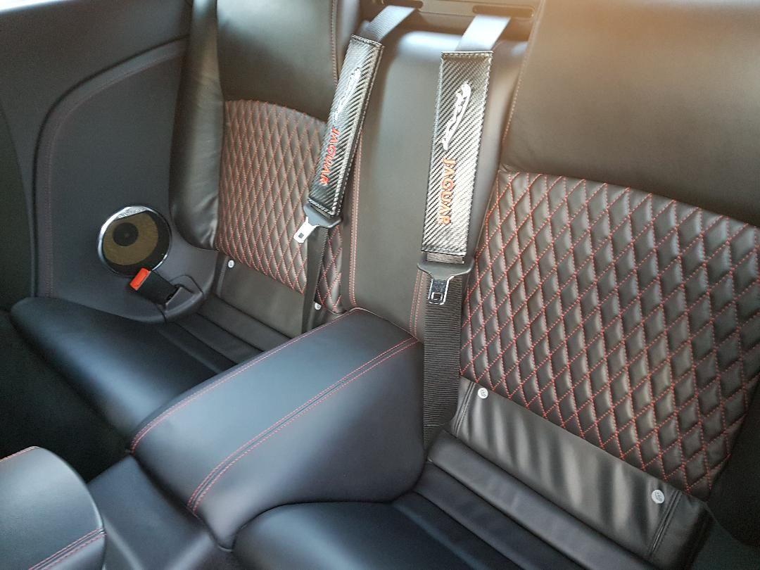

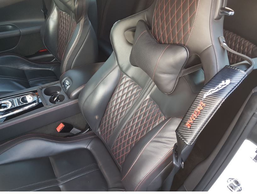

I’m gathering you want to put the performance seats in your xkr
xkrs seats in
2010 and upwards should be a straight bolt in plug and play / recalibration in SDD
2007-2009 (4.2) - wiring harness requires modification and seat modules from 4.2 into 5.0 seats would need to be swapped - Cambo is currently working on a harness adaption plug for me at the moment to make it all work
At time of purchasing my seats Cotswold automotive also had a xkr-s black/red stitch also available

Mine, not ventilated though, so ideal for cooler climates
Reply 1

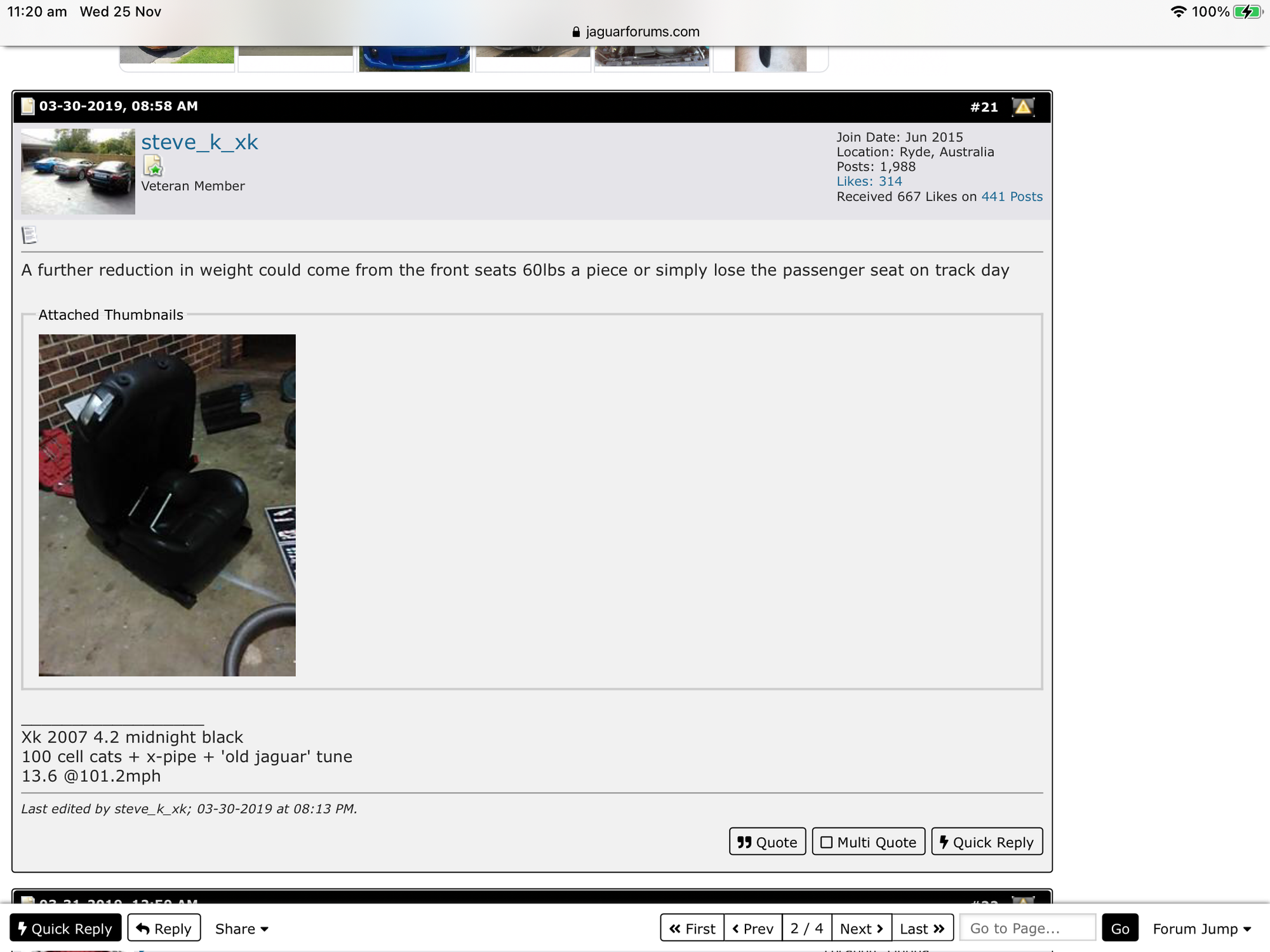

Steve,
Have you had a chance to weigh the original 16-way seats?

Weighed up the 16-way passenger seat and it came in at 78 pounds which seems more like what I recall from 6 years ago when I had them out. Definitely heavy to carry compared to a 50 pound tyre/wheel.
Reply 0
Nov 24, 2020 | 06:13 PM
CORRECTION - I’ve was a few pounds off the mark the xk seat actually weighs in at 60LBS (not 47lb as previously mention)
Nevertheless it’s a decent little saving of 36lb or so over the xkr seats

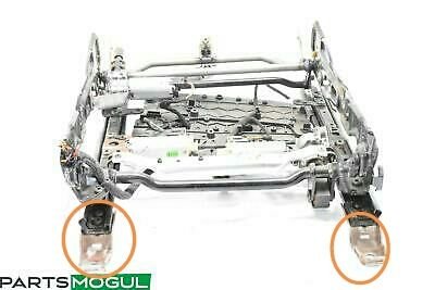

Steve, Can you confirm the seat mounting points for the X152 and X150 are the same?
Reply 0
May 16, 2021 | 07:07 PM
You'll need to swap around the mounting brackets so hold onto the ones from your xkr
Reply 1
May 16, 2021 | 07:38 PM
Right, so they're not the same then? Asking because I was going to post up in the F-Type forum regarding seat bases for race seats. So if the X152 mounts aren't the same as the X150, there wouldn't be any point then...
Reply 0
May 16, 2021 | 09:52 PM
The rails are the same it's just the mounts that would need to swapped over which are two torx bolts per corner
So they would work one would just to retain their own mounts that are specific to x152 and x150
