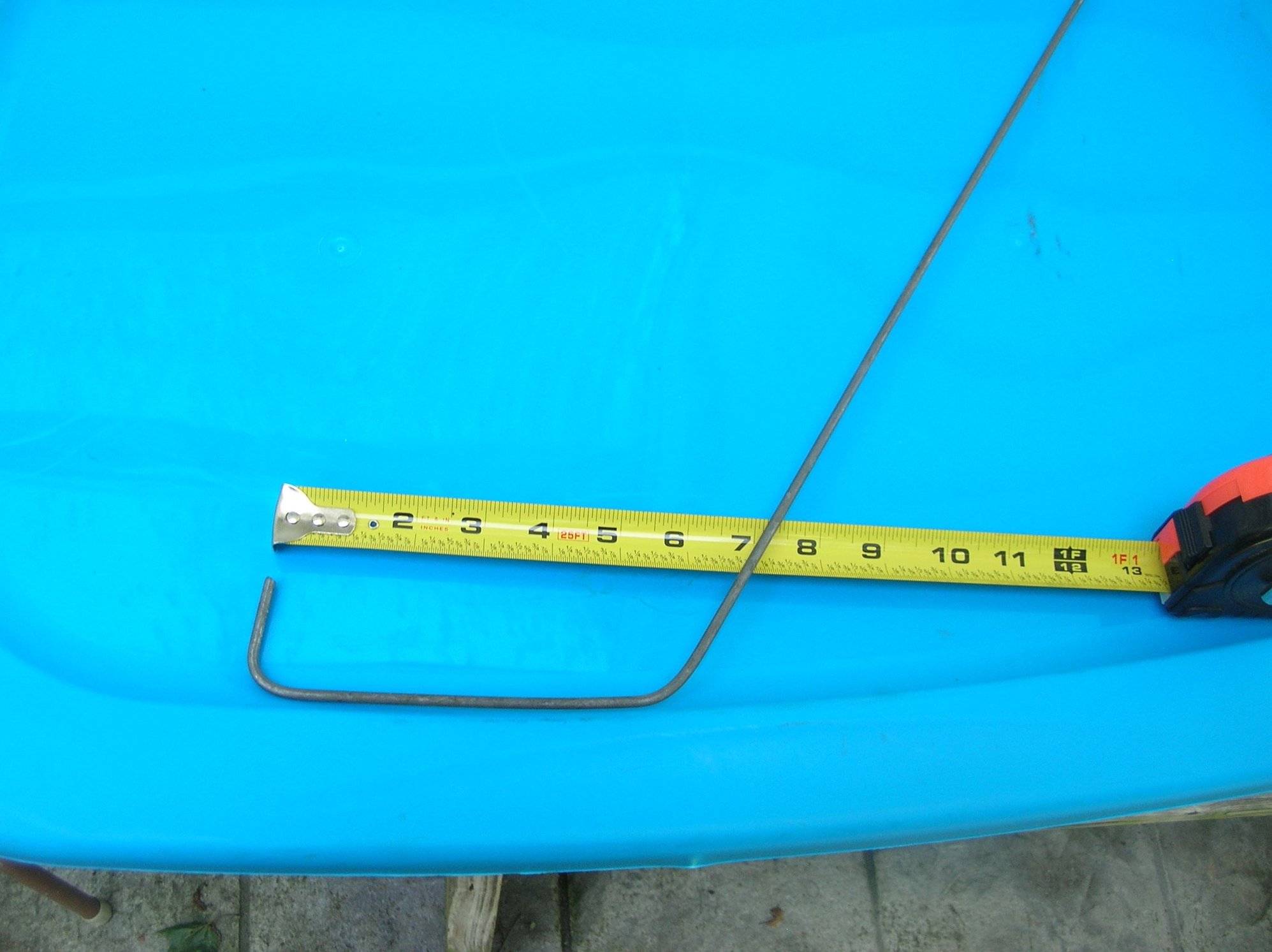

Try to clean out the drain with a wire...worked for me on my 2007 XK...took 5 minutes...just follow the centerline of the trans from above and if you make the wire long enough you don't even need to take off the engine cover
