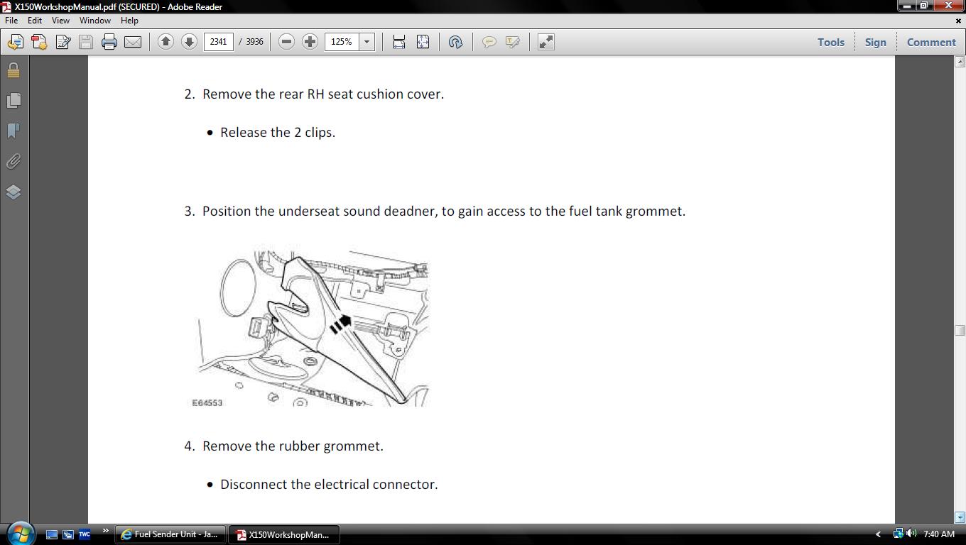

I remember reading the '07 manual and if memory serves you remove the right rear passengers seat (bottom portion) to access the fuel pump. There's a sound deadener under the seat that also has to be lifted up.
If I were you I'd download to your computer, the maint manual online for ??? what??? ten/fifteen bucks and there you'll find instructions for removal of the pump.

Funny thing in the workshop CD I got under the FSU section its as WhiteXKR described but under Draining the Fuel Tank Hailers access is shown (much easier too). My version is also a different page then Hailers post... I found this all very weird.
Now onto the hard part, checking the floater and meter contacts, unfortunately it looks like you can't just buy the sender, you have to buy the pump as a whole unit at $400 bucks. Hopefully the existing unit can be fixed.
