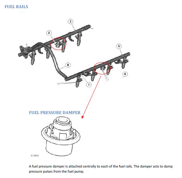

Thread resurrection, only to add data to the search for "Fuel Odors".
This odor started on my XK about two weeks ago. I tracked it down to a bad fuel pressure dampener (basically an accumulator to dampen injector pulses in the fuel rails.) Was weeping fuel as the car ran.
A basic part, one on each rail, and snaps onto into place....
Problem: Jaguar does not sell what should be a simple $100 part.... They sell you the $1000 fuel rail instead... Grrrr
Thanks Jaguar...
Needless to say.... not buying it....
Benefits of a pulse dampener have been questioned for years, as they are known to cause of engine fires when they fail.
I will pull the unit hoping the mounting seal is what failed. Might be saveable...
If the diaphragm is gone, then I may thread and seal the opening, or adapt a dampener from another car.... (Probably $50 from Ford)
... Unless of course anyone has a spare dampener laying around?
Wanted to get this out there as it is bound to start happen to others as our cars age....
Vince

Old 12-01-2014, 08:49 PM
amcdonal86's Avatar
Join Date: May 2010
Location: Arlington, VA USA
Posts: 6,290
Received 482 Likes on 403 Posts
Great post. I hate when they don't sell individual parts!
Thanks Jaguar...
Vince
Call Injector Cleaning & Flow Testing Service - Injector Rx. It has been reported that they will cap the dampener for about $100 and several reports in the XK8 group of no adverse effects at all from a capped dampener.
Thanks, but not a problem. (I have a used rail on the way... Fingers crossed that it is good!)
I see older Jags use to put the dampener in-line with the cross tube between rails. Might be worth a look as well... Worst case , I'll tap and seal it myself.
BTW: RC Engineering is another recommended injector service here on the west coast for those interested.
Vince

Originally Posted by captusnr
2007 xk convertible 70,000 miles. Strong gas odor in cockpit upon start up. Disappeared when driven. Dealer replaced fuel rail. Odor gone. So is my money. Also had to replace faulty thermostat at same time. Someone once said owning a Jaguar is like keeping a mistress. Beautiful but expensive.
A fuel rail is almost impossible to damage, so I would guess you also lost the dampener as well. These are nothing more than a rubber diaphragm, that flex with varying back pressure in a liquid system. (In hydraulics, we call them accumulators.) They will certainly be the first thing to go, and not the metal rail itself. Bet we start to see more of it as our cars age...
