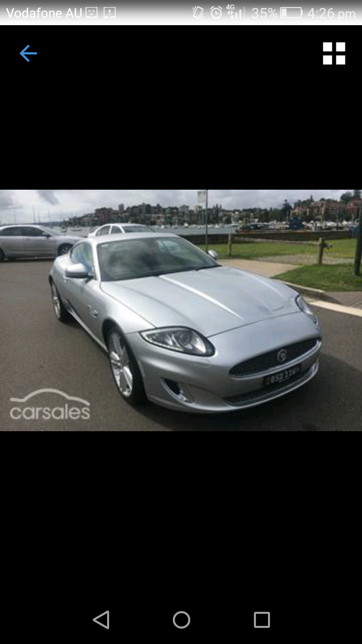

Originally Posted by Cee Jay
If you don't like the super-out-of-place shiny "Bug-Eye" look, maybe try some 10% tinted headlight film. It still has the UV block, but it also tones down the horrendously too-shiny headlights during the day with nearly no ill effects at night, especially on darker cars.
No faulting the facelifted version
Looks so much sharper
Attached Thumbnails 'The Green Turtle' or 'Lets Fix This Junk'-screenshot_2017-05-06-16-26-18.png
