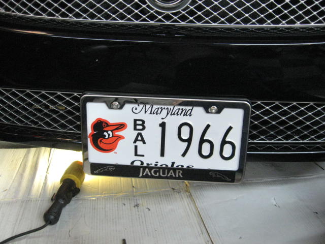

BTW, you mentioned wanting to reduce the foot print of the front tag. Have you heard about the Show 'N Go plate? It's a moble front plate bracket that stores beneath the car when you don't want it showing. However, as you know, we need to display. I added one and it works really good.

Ken, thanks for the idea. I had thought about it but I've found myself putting the nose over stuff more often than not so it wouldn't work out well for long.
