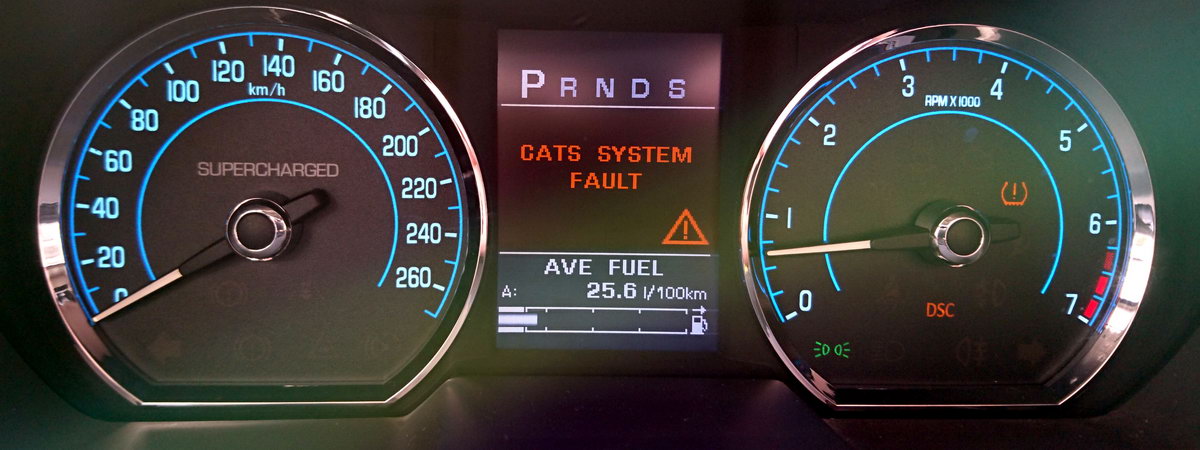

I had done something silimar to my odo. i didnt liked stock XF odometer, so made custom facelift with supercharged letters. i didntliked blue diodes, spo change them to white. then it wass tobright so covered with slight dark colour to make them better. and then colour was off to center console so again bought new odo and this time used very low consupmtion daylight diodes. and tinted one of the circele rmp and km/h labels when in dark. now cars (with upgraded interiorand repainted looks more like 2015 years model and its a joy to read odometer data now.
Attached Thumbnails 'The Green Turtle' or 'Lets Fix This Junk'-1.jpg   'The Green Turtle' or 'Lets Fix This Junk'-3.jpg
