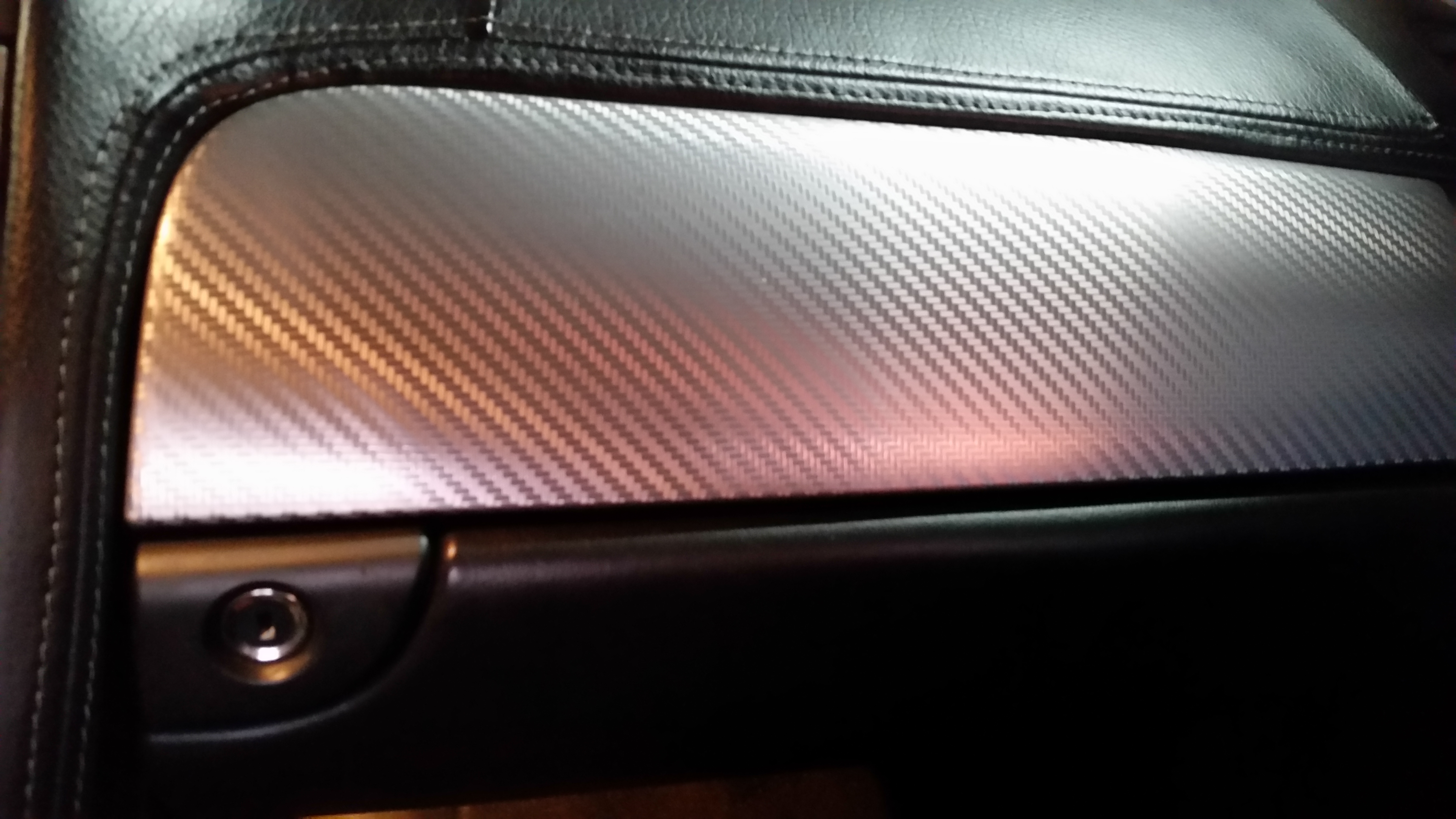

Originally Posted by Ranchero50
It's from Autogoody off eBay, 3x5' chunk for $17 delivered. It's a mat 4d silver carbon fiber. it does have a texture so it covers some imperfections (like the crack in my pass panel). As it's the Chinese knock off it doesn't conform as well as the Vivid and other higher end makers. It's considered a 'calendar' product which is pretty thick versus a thinner 'cast' one that flexes more. Plus I'm just learning how to use it and probably not using enough heat to set it. It has a slight tack of adhesive on the back so you use heat to help it conform to the panel. Tons of stuff on Youtube about how to apply it.
It's vinyl but acts like aluminum. You need to know when to stretch it and when to shrink it. Using hot air to do both. It'll also relax with heat so you heat it, form it while hot and let it cool into form. It can be a little frustrating having some of it relax and come loose around the edges while you are working on a section next to it.
I did the side covers on my Sportster in 5d gloss blue to learn about the product before taking the car apart. I think it turned out OK. There's supposed to be a high gloss cover but I crinkled it and peeled it off before realizing I needed to use heat. I'm going to do the fairing once I get it finished.

Overall I like the look, but the color is wrong. I've also noticed the wrap lifting already. Install issues or bad material? Probably a little of both. Once I get caught up I think I'm going to do the brushed stuff with a lot more heat to help activate the adhesive. Sometimes learning something new is a pain in the behind.
