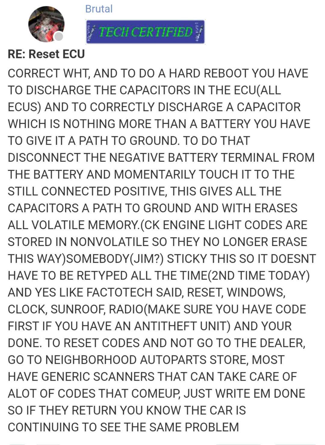

Here's the right way to do a hard reset, from @Brutal , a Jaguar Tech who knows his stuff:
https://www.jaguarforums.com/forum/x...eset-ecu-4258/

Oh man...I am no qualified tech but touching a ground to the battery makes the hair in my nostrils stand out and puckers me up.
I will just settle for removing the cables, crossing them for a solid 15 minutes and then re-attaching. I find that clears the capacitors.
Buy your mileage may vary.

The REASON you disconnect the battery leads, then touch them - is to clear all the capacitance in the system. There are other ways of getting it done too.
