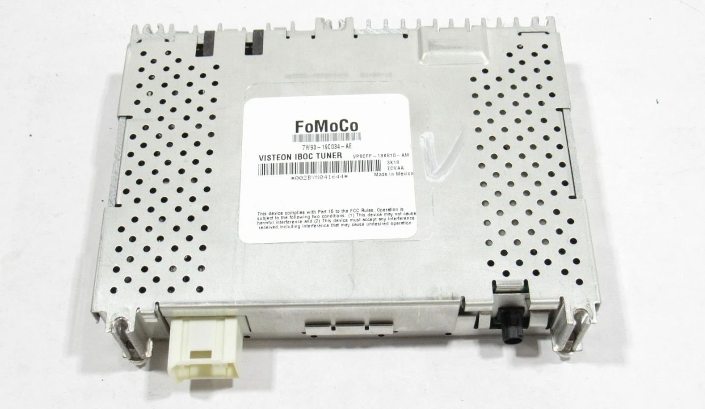

I wanted to bump this thread... Forgot I posted it. My HD radio has changed from intermittent to completely stopped working. As soon as I turn it on in the audio settings, it turns itself off.
Anyone know what module controls the HD radio? Is it the part below?
I believe it's this: C2P26033 or 7W93-19C034-AE
Or this: C2P2761 or 6W83-19C061-AB

This is fixed by replacing 7W93-19C034-AE. This is a generic Ford radio tuner part number, though I found one on eBay from a 2015 XK for $25. No programming was needed.
HD Radio was already enabled when I started the car after testing, and HD stations tuned in with great clarity.
